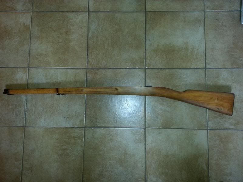

ok my pic are just from my phone
http://i43.photobucket.com/albums/e396/dimenickel/M1896/20130616_102726_zps6729da7b.jpg
[/URL][/IMG]
[/URL][/IMG]
pic's not so good but you get the idea... the wood was very whitish almost like maple ... there was some grease stains/oil that has bleed right into the stock... had to leave those
-dry cracks here and there... use a very thin super glue from leevalley called special T .... fill up crack and it'll seep in nicely...do it several times then sand flush ( it'll look like glass )
only 5 applications of the 3 part solution on this stock.... with 2 day wait inbetween applications
