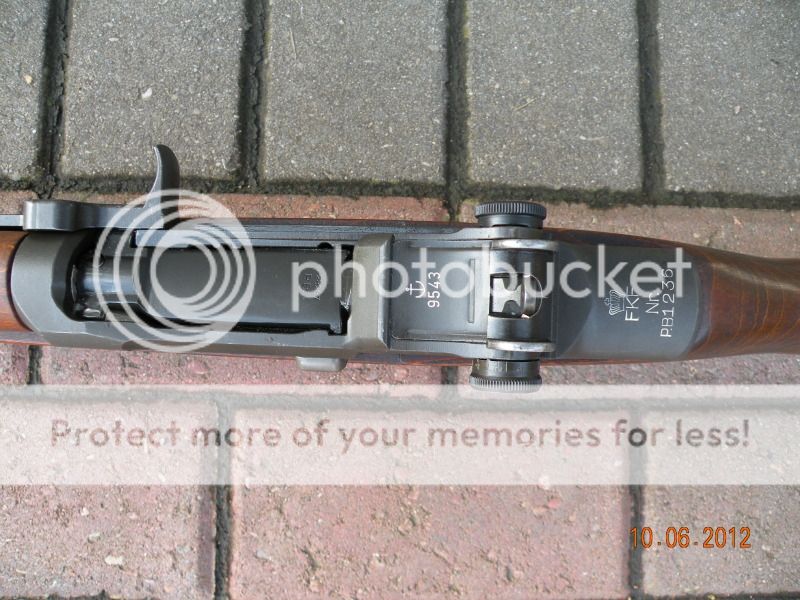

I wonder if the unit designation is a valid meaning for that number --- here's a sight cover showing the Danish Navy anchor and a 4 digit number -- I can't imagine the sight cover would be numbered to match the receiver:

The anchor and number marking on the rear sight cover is believed to be a Danish navy inventory control number which seems redundant, given that the rifles themselves were serial numbered. I've owned several with the anchor and number and the number never matched the receiver s/n.
Spoke to a danish guy who was looking at my garands at a gun show and asked him about the navy markings and he said same thing navy stock#
