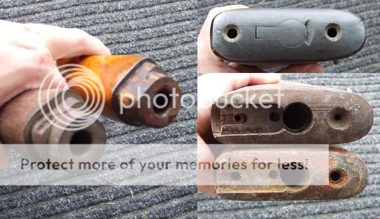

Yeah well mine had a lot of white corrosion on the screw head and was quite stubborn. I removed the butt stock, chucked it into a padded vise and got the butt plate off.
New problem. The butt plate that I have is now about 1/8" smaller than the butt stock I have. The holes for the butt plate screws seem way to small for the screws I have. Is there a different butt stock for the No1 and No4? I bought a No.4 stock set.
On a new buttstock, the stock is a bit wider than the plate, yeah, about 1/8 inch all around.
Are you sure the screws are the right ones? There was an armourer tool to thread the holes to the right size and thread...hopefully that has been done. If the holes are obviously too tiny, you might need to open them up enough so the screws will still bite well but will thread in.
Thanks for the help guys.
In this pic it shows the two buttstocks. On the left, the part that goes into the receiver is a different shape. Is this really a No.4 Mark 1 buttstock?
On the right shows the buttplate and the approx. 1/8"wood around it. Then bottom right shows the two buttstocks, bottom blonde one is my bubba, top brown one shows the smaller holes. I'm pretty sure they are the original screws as they are really coarse thread and just look like something off an Enfield. :)
So should I just drill out the screw holes a bit and then file down the buttstock to blend toward the buttplate? How far towards the grip should I start the blend?

Note that the wood is wider than the plate.
Now, did armourers spend the time to file the wood on new buttstocks down flush? I have no idea, but I wasn't doing it to mine. Interested to hear other opinions on that.
As for the screw holes being too small, I believe I've run across that before, and I drilled the holes out a bit so the screws would fit, but threads would still bite.
I've seen several different styles of socket on different buttstocks. Is your new buttstock marked LB for Long Branch? If it is, then it's for a No 4, if not, then it's Brit or other and who knows? For a 42 LB, I'd want a LB butt.

lou, should I work the rear of the butt stock with a file to match or mate up with the butt plate, leave it as it is in the previous picture or order a brass butt plate?
Canada never used brass butt plates, you want that black one in the pic or a zamak one like in my pics.
Re. reducing the size of the butt stock: personally I would live with it as is, unless it's really too large. If there's a bit of extra wood I don't think it's too bad. Thinning the butt stock and not mess it up is doable but if you can avoid that task, I think it's a better option. My 2 cents, anyways,
