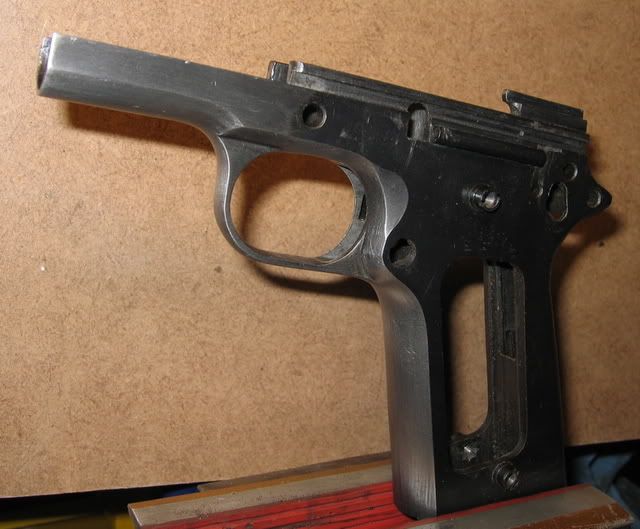

Well it's not that I'm ashamed of my Norinco but I've always wanted to remove the "exported by norinco" and "made in china" stamps on the frame.
Well I finally got around to it, about 6 hours... over two days.

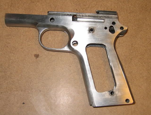

Removed the stamps with a diamond stone.
Then took off the rest of the blueing with some casey blueing remover and evened out the metal with open mesh abrasive strips.

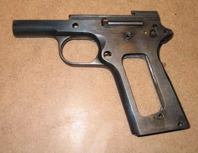

Re-blued with oxpho blue.
Re-assembled.
I didn't touch the slide but it could use some de-horning as well.
Cheers, C

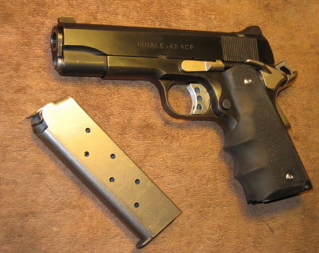

Nice work! is that an aftermarket trigger and Hammer? if so, what are they and how much did they cost?
nice, I like your grip, also want to change my commander's grip, could you please tell me which dealer sells this type grip?
Thanks.
I don't know what the parts cost as they were on the gun when I bought it...
The grips are Hogue you can get them online from hogue or at most gun shops.
The aftermarket parts are,
Nowlin trigger kit (hammer, sear, disconnect, sear spring, main spring)
Wilson Combat trigger
Para Ordnance S/S saftey
Para Ordnance S/S beavertail
Para Ordnance S/S hex grips screws
Kimber night sights, machined into the slide
Hogue rubber finger groove grips
King's match barrel bushing
Wilson full length guide rod
Chip McCormick extractor

Let's see here,,,the only "Norc" thing about the gun is the frame, slide and barrel...correct.
Looks like you got a keeper there!!! Good looking pistol, like all slab sided 1911s.
Bet it shoots well too!! Who cares if it is a "Norc" as long as it shoots, that is all that matters.
