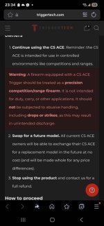

Look at the reviews on the triggertech glock trigger. If they haven't done a full recall yet, I would be shocked. Incredibly unsafe
I have a Triggertech, and there are three options. Panic and drop the gun on the range floor; continue shooting until their lawyer suggested replacement kit is available; or carry on and remember that the world is run by stupid people who believe on line reviews.
Looks like they are offering to buy them back so you have another option šŸ˜‰. Also, video testing of the product and its failures are not really just an online review.
