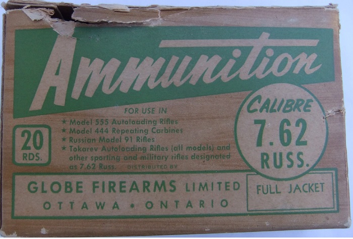

Either way, what they came into was almost certainly a random collection of mismatched junkers - missing parts and presumably with hopelessly corroded bores from being stored for decades in damp warehouses - having never been cleaned after their last use firing corrosive ammo. We know that Globe Firearms sold any nice SVTs that they acquired in an unaltered state and even sold its own line of 7.62x54R ammo (click on this LINK) to coax reluctant US buyers to acquire one of these odd foreign military guns (see my post on this - LINK). Any guns with Okay original bores, but broken, or missing stocks (a known weakness of SVT38s) were presumably converted to 7.62x54R Mohawks. Those with hopeless rotted bores and missing, or broken stocks were converted to Mohawks in 303 British. This was done by fitting NOS Mk III barrels to the gun. If you understand machining, you would appreciate the complexity of this operation. Other changes were made to the magazines to complete the conversion.
