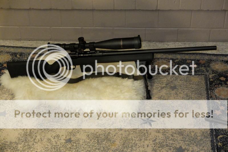

I went with the Sightron III, FFP in MOA:
Yes, I'm quite thrilled with the Sightron. It really does work as promised. Here's my Savage 10 FPC HS, .308 c/w 10 round mag.
The scope is resting on an old 'Bee Square' Weaver rail with Burris XTR rings. I just plopped the Sightron on there the night before, torqued it down, set it up on my back porch table, and did an old-fashion 'eyeball boresight' at a 1" dot 25' away.
The next day we were out to the range with 25 rounds of "Hornady MATCH 168gr A-MAX". I used that bipod with a bag of rice under the buttstock.

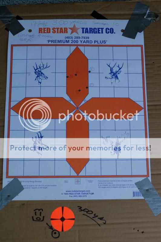

And here are the results of our first outing together (and my first venture out beyond 100 yards since my Army days!). My first round hit the paper at 100 yards, so I was able to sight-in and get a good 100 yard zero, then shoot four 3 round groups of .26", .36", 1.25" (flyer) and .56".
Then we put this monster target out at 300 yards. I cranked the Sightron's elevation drum up 12" from my 100 yard zero, according to the ballistics chart shown on the bottom of the ammo box, settled in, and squeezed off 5 rounds.
Each square is 2" on a side, and my 5 shot group measured just under 1 MOA.
I could actually see the holes in the paper thru my scope (better than with my spotting scope!). So my upping of 12 was a bit too much. Next time I'll try cranking in just 8" of elevation.
I had four cartridges left. I aimed about 5" below that orange dot near the bottom and came purty close :0 ]
Then I rang the 300 yd GONG. With my last two remaining rounds, I moved the reticle back down to my 100 yd zero and poked two holes at .68 MOA.
I would liked to have gone for those four animals out at 300 if I had just four more rounds left. (;0 D
