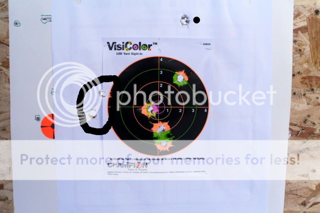

Best I can do with Ithaca Deerslayer and factory irons with foster slugs @100 yards from a rest. First shot was very high and I adjusted the elevator. (smoothbore 12 gauge)
The circled group to the left was when the action bolt came loose from the receiver and I stopped shooting to ID and fix the problem.
