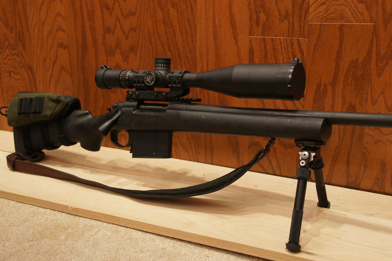

Here's the old girl I am aiming to replace.
Did the cheek riser myself. Tac-ord did the Fat Bastard muzzle break, bolt handle, and bedding.

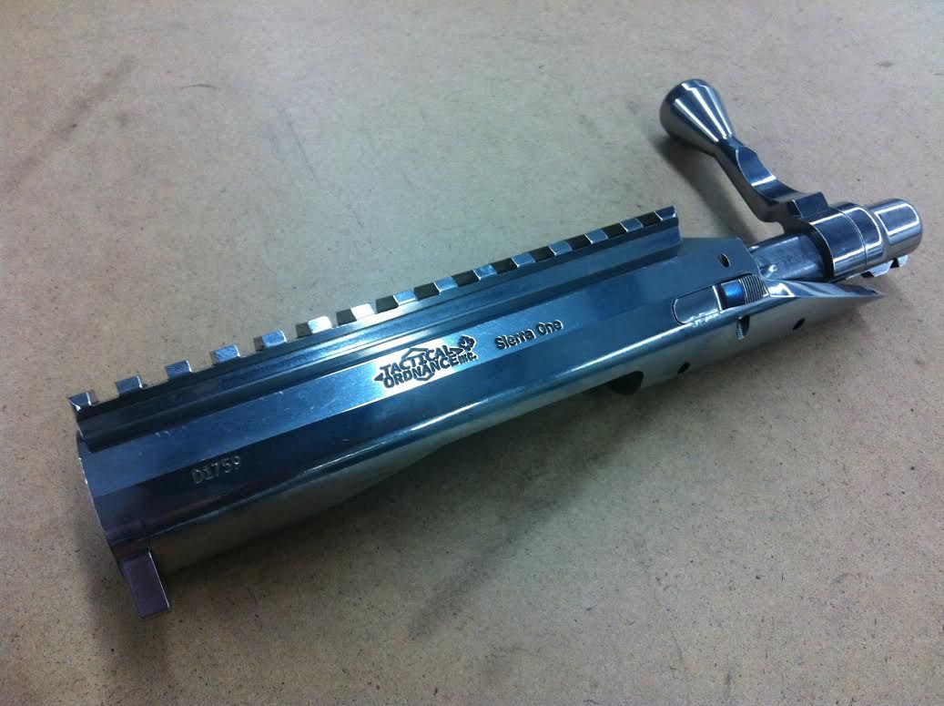

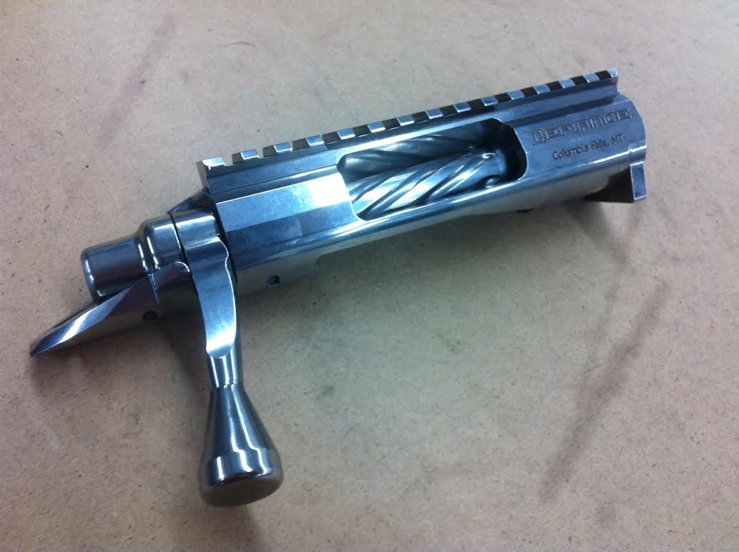

I have secured my first part of the whole project, a custom branded Defiance Action, built for Tac-Ord. What a sweet action! I got to fondle it for a while, and the thing is just a work of art. I could not ask for a better foundation for my dream build than this very action. Receiver is a machined one piece machined, pre-hardened SS, the picatinny rail is an integrally machined 20MOA slope. Full length lugways are wire EDM-cut to limit the stress in the receiver material. Bolt is .750", one piece machined, pre hardened 4340 chromemoly and threaded for interchangeable knobs. In short, just a beautiful piece of machining.
This is a pic of my actual action.

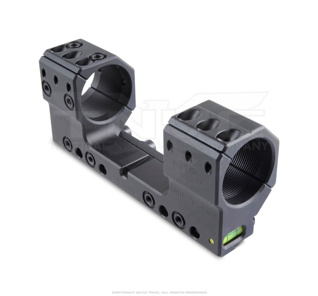

SPUHR ISMS. I already have one, and it will be going on this rifle. The SPUHR Ideal Scope Mounting System is the best scope mount money can buy, period. Rugged, smart design, lightweight, what else could you want but a lower price tag? I won't have anything but this mount on my LR rifles. Currently debating getting another one if I can get one with more cant then the 20 MOA model I have at the moment.
