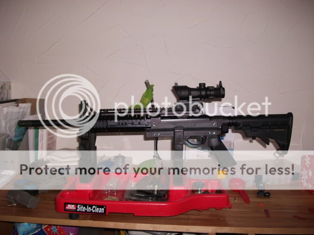

Mine is still cheaper the a stoch sr22 with all the trimings you see here
it looks like you have cut slots in all the screws that hold the side plates on. those little Allan heads are a royal pain in the butt.

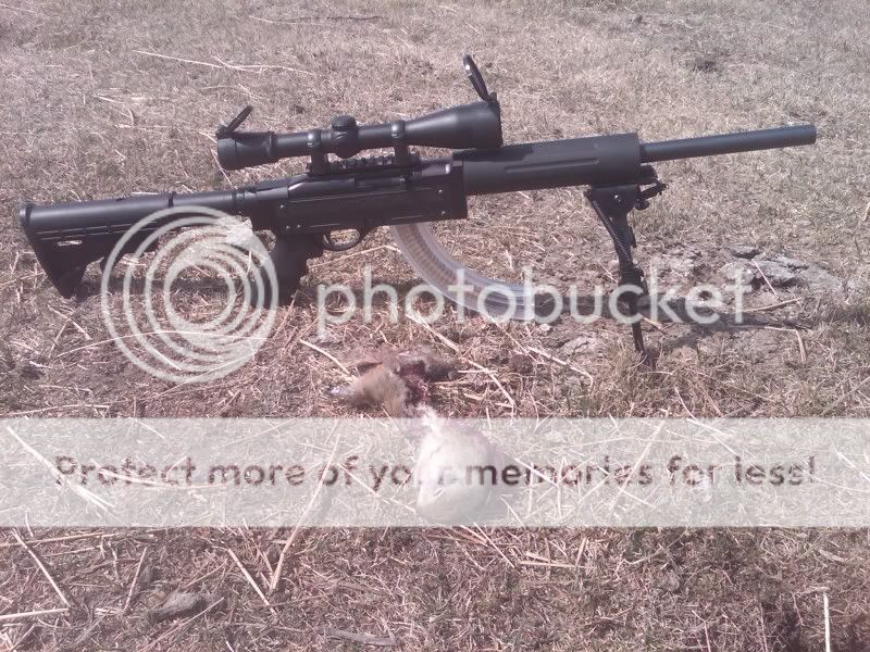

but ill put in my vote for the VTR...i have handled and SHOT both and i own the remington
Check guide rods and keep it clean and it feeds better than any 10/22 ive used with high cap mags...rapid fire...waxed bulk ammo...doesnt matter it eats it all
Accuracy is better out of the VTR too....we ran 5 or 6 different brands of ammo through both guns and the VTR did better everytime.
I looks similar but shoots/functions better...and is cheaper
no brainer...im keeping my VTR
** Disclaimer : gopher in pic was obviously not shot with a .22LR, rather a .223rem **
Oh dear L*rd, that's futuristic-looking!
There might not be a lot of money into it, but it looks like you put a lot of thought into choosing components - very nicely done!

The whole thing really did not cost a lot and was easy to do. All I have left to do is paint it. First you have to unscrew the hand guard and the ring. Yes it is tight! Next I ground down Part of the mounting block to allow the rail to slip over. Since I’m not going to war I used an Airsoft Vltor knock-off which can be found here. w w w.waridiot.org/index_eproduct_view.php?products_id=58 . Don’t let the cheap price fool you its really solid. Last year they sold it for 10 $ less. They are not fast and their communication suck’s but it was worth the wait. The front sight is an ARMS knock off which was milled out to 13/16 of an inch by a friend and just slipped on and tightened up quite well with the provided bolts. I used a real A2 bird cage just threaded the stock barrel and used lock tight. The rear stock cane from Questar and I sold the A2 stock and the buffer tube and almost broke even. The rear sight is from Questar also and is made by UTG. The scope is a ACOG knock of and really is clear and holds zero quiet well.
Email me if you want more info
