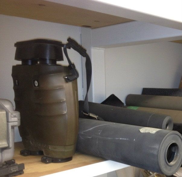

Here is some Range Finder #### mmmm soo nice I want! The person who owns them could be nice and loan them to me I promise not to break them;) hint hint! jk
