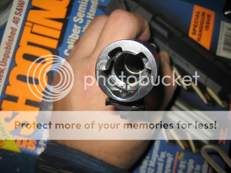

If you field strip your DE, look through the back of the barrel at the chamber, in recesses where the bolt locks up, in the six o'clock position there should be a screw closing off the gas system. If that is open it could be your venting problem.
Let me know if you would like pics.
Yes please for the photos.
I am looking, but I don't see the screw you are talking about.
Maybe it is an odd shape or size, or maybe I am just missing it, but I don't see a screw or an empty hole in the 6 o clock position where the bolt locks up. I see the gas port further down the barrel, but no spot for a gas screw.
Thanks.
Here is the view I was talking about. The highlit slot-head is a screw that covers the rear of the gas tube.
(Mine is a US production Mk XIX 50.)
