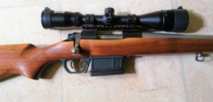

I have a kwik klip mag conversion for my 7mm08. Mag holds 4 rounds but it was a tight fit, sat in the magwell better with only 3 in the mag. Fed fine either way though.
It's all metal. Basically flush mount, the middle of the mag isn't flush but the edges are and it's a smooth transition. IIRC it actually weighs less than the factory hinged floorplate setup too.
I prefer a hinged floorplate so I can't accidentally forget my magazine. Otherwise I'd probably still be using it.
