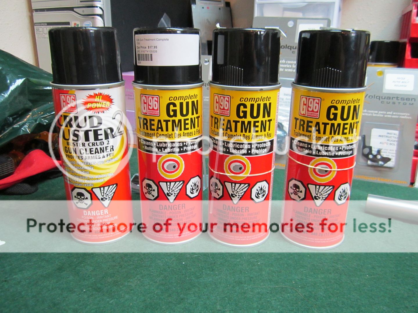

and he's never cleaned it so this was also in the bag
so ripped the gun apart and gave it a hard cleaning with the G96 gunk remover.
then cleaned it up and oiled with the G96 Gun Conditioner.
