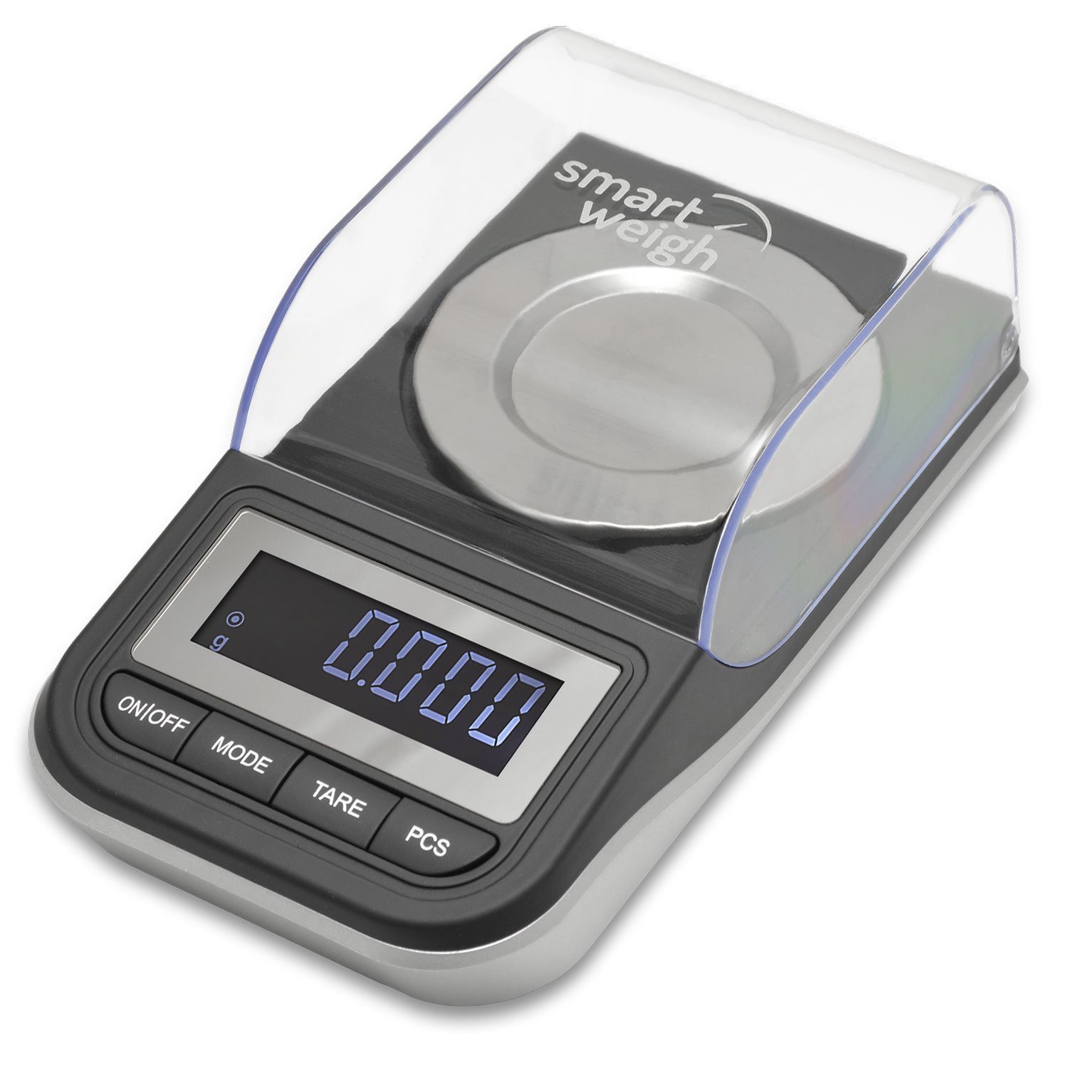

Amazon.ca had a flash sale on this scale for $29.99 last week so I picked one up. It seems pretty accurate when compared to my beam scale and doesn't drift. I will look into getting some gn weights to test as mentioned above.
https://www.amazon.ca/gp/product/B011J88S8M/ref=oh_aui_detailpage_o02_s00?ie=UTF8&psc=1
Hawkeye, all cheap electronic scales drift.
