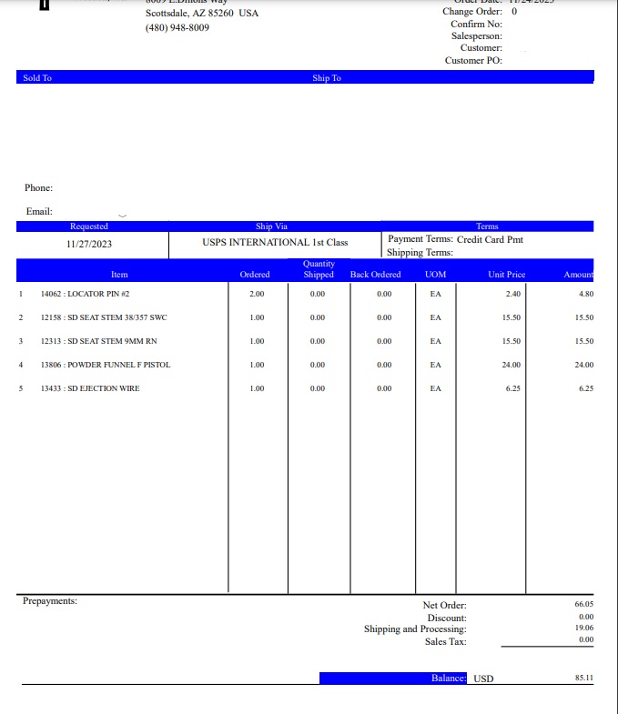

I got an email back with the quotation for the parts.
