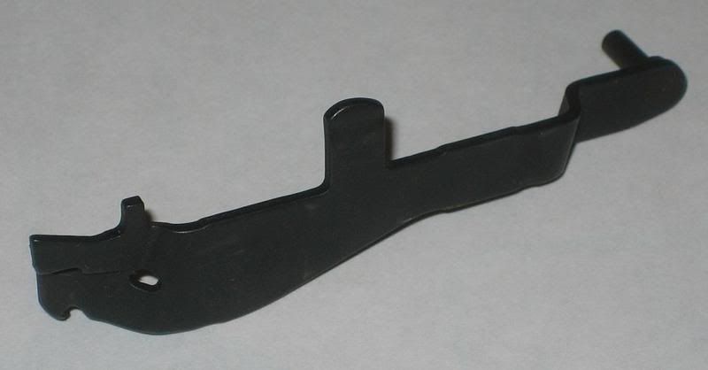

Have you seen the disconnector get ground down to the point where it starts to affect the function of the gun?
For noobs, I mean the bump on the trigger bar that sticks up above the frame on the right side of the gun. When the slide is out of battery - the slide itself pushes this bump down and disconnects the trigger from the sear.
Here's my thing... I have two of the 229's. The older one is showing significant wear on the "bump" such that a notch has been carved out of it on the side of the bump closer to the frame - maybe a millimeter or two deep. I'll try and get some close-up pics of it tonight.
In testing the gun with snap caps, I noticed that once in awhile if you fire the gun.... hold the trigger back after firing.... and then cycle the slide so that a new snap cap is chambered... the hammer will return forward with the slide.
O.k., that is bad. "WTF" is going off in my head. Is the hammer and sear buggered? No, I've checked that out. The next test settled it though - at least I think so.
One of the things it says in the SIG armorer's manual is to check and see if the trigger will have any effect on the hammer when the slide is out of battery. This is the test to see if the disconnector is working. With this gun, you actually can release the hammer when the gun is partially out of battery. Not at any place on the range of movement of the slide, but when the slide is about 5mm or so out of battery you can release the hammer. I duplicated these tests on the newer gun (which is only about 5 months old, although it is being shot a about 250 rounds a week as well) and I could not duplicate the results of the hammer going forward with the slide when the trigger is held down, or being able to release the hammer when the gun is slightly out of battery. The disconnector bump on the newer gun is more polished on this gun than "ground down" like on the older gun.
I will post some pics tonight hopefully... but I just want to see if anyone else has had this problem and if they think my diagnosis is correct. I can get a new trigger bar from Brownell's. It is like a $75 part though. And I've only had the gun for a year.
I think the 229 is a fabulous gun. It may just have become a victim of it's own success though, in that it has been shot so much since we got it. It has got to be around 12,000 to 13,000 rounds now. That is all since August 2007. The recoil spring was replaced about half way through that, and I am going to replace it again right away. Other than that it is the way it came from the factory. It still works fine with live ammo, we have never experienced any problems with it at the range. But testing it at home after cleaning it this came up. Now I'm worried that it might fire out of battery and really damage the gun. I guess it should be put on the injured reserve until I get a new trigger bar.
But my question remains... is that just part of the "deal" with these guns? The slide grinds the trigger bar down until the gun doesn't disconnect properly? Is there a way to slow this down with some kind of special lube or anything?
Thanks for any suggestions.
