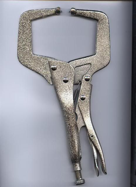

I made my flash hider pliers a couple of years ago out of a set of el cheapo vice grips from Princess Auto. They work fine, and cost me all of $5.
