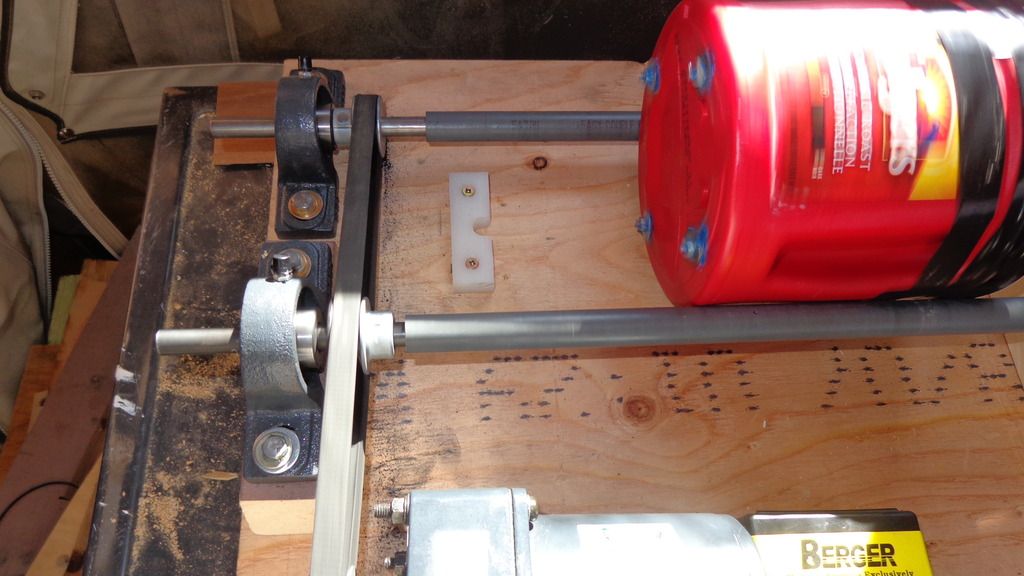

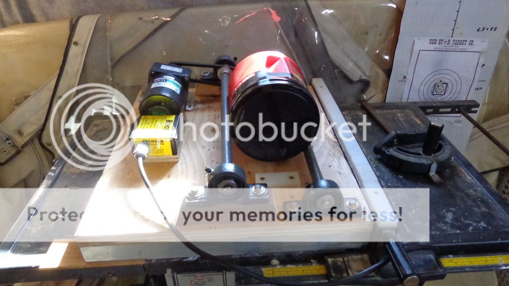

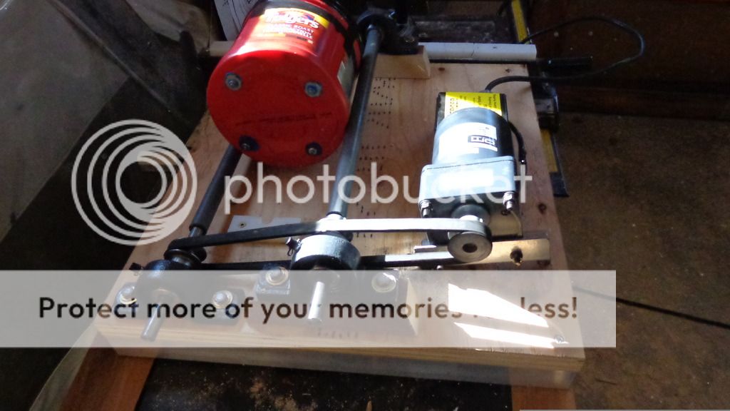

TUMBLER DIY WINTER PROJECT. I have been wanting to do one of these finally got around to it this winter. Costs, bearings from B.C. Bearing $12. each, motor, stepper motor from auction site, one is for sale $35. each motor required a capacitor $10. each, I bought two, the motors have reduction units on the drive end. Pulleys were $8. each. Add to that the cost of 5lbs of SS pins, shop around for these prices are all over the map on these. Anyway in answer to the question, would I buy a factory edition rather than build one NO I'm satisfied with what I now have, this one will allow me to use tumbler barrels all the way up to the 20L water jug if I choose. I have jugs of varying size and degree of aggressive tumbling, depending on what I'm tumbling, 2hrs does the trick. RPM of tumbler is about 50RPM

LOL did you use a Berger bullet box for a junction box??
Innovative thinking!
Yes the berger box is the junction box and contains the capacitor, it was on my bench and the right size. Both pulleys are 1.5" OD, ID .5". The motor is reversible if required. I have not been able to find the Lemi Shine, but the Dawn3X works very well.
Enjoy.
