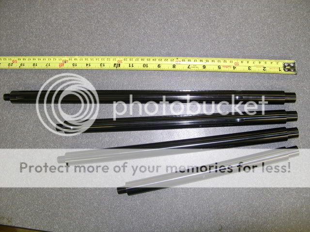

I don't have many pictures handy now.
There are 3 lenghts: 12", 16" and 20".
The 12" is non-fluted,
20" is fluted,
16" has versions of both fluted and non-fluted.
As I said, all barrels have threads at the muzzle,
and I believe the next batch will have a thread protector.

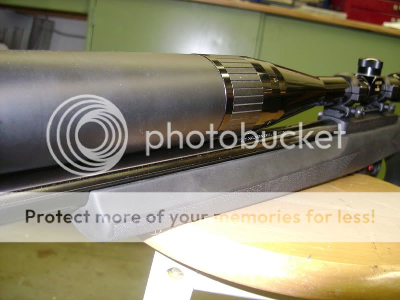

The fluted barrels have 5 square flutes (and of course, 5 ribs).
When the barrel is assembled on the gun,
one channel is always on top (right under the scope)
and one rib is always at the bottom.
On most of the stocks, one flute channel stays
right above each lip of the barrel channel of the stock and parallel with it,
like this
