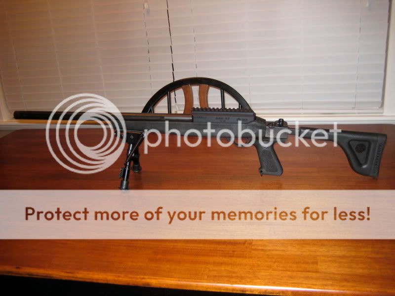

Here's a pic of what I have so far...

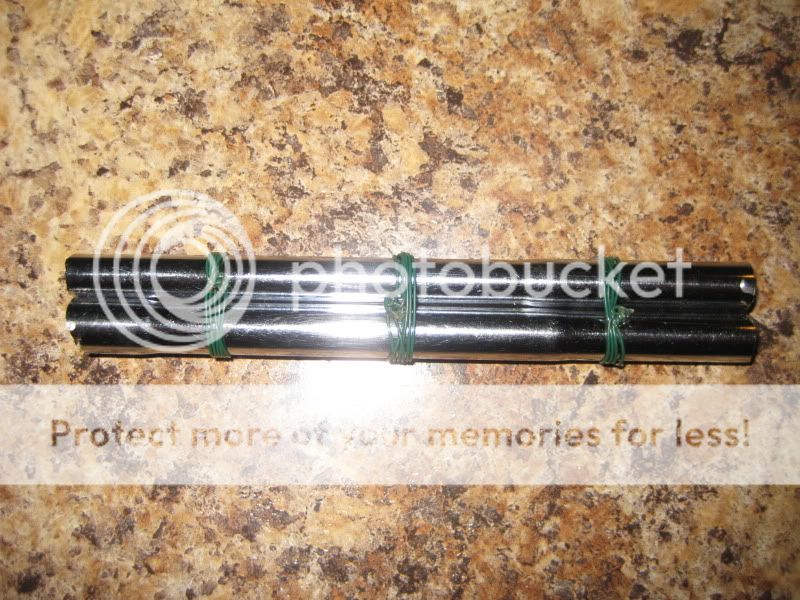

My dremel skills suck, but these two shafts are quite rigid and should help to limit movement somewhat without adding too much weight. I'll add them to the forend and epoxy them in. I cut them from and old wooden driver that I had. I suck at golf, so believe me that old club has served it's purpose better in this way than in my hands on the course!
I also have to hog out the barrel channel and try to come up with some way to put a pressure pad at the forend . I've cut the stock back to just forward of where the barrel band would have gone, so there's only a few thin structural supports to put the pad on.

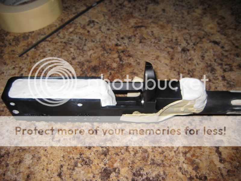

Here's a pic of the action just before bedding. I had to use two packages of JB weld to be able to bed the action because the stock was so hollow. I used putty, masking tape and Kiwi Polish as a release agent. Note the putty I built up under the V-block to create a channel for the V-block to sit in.

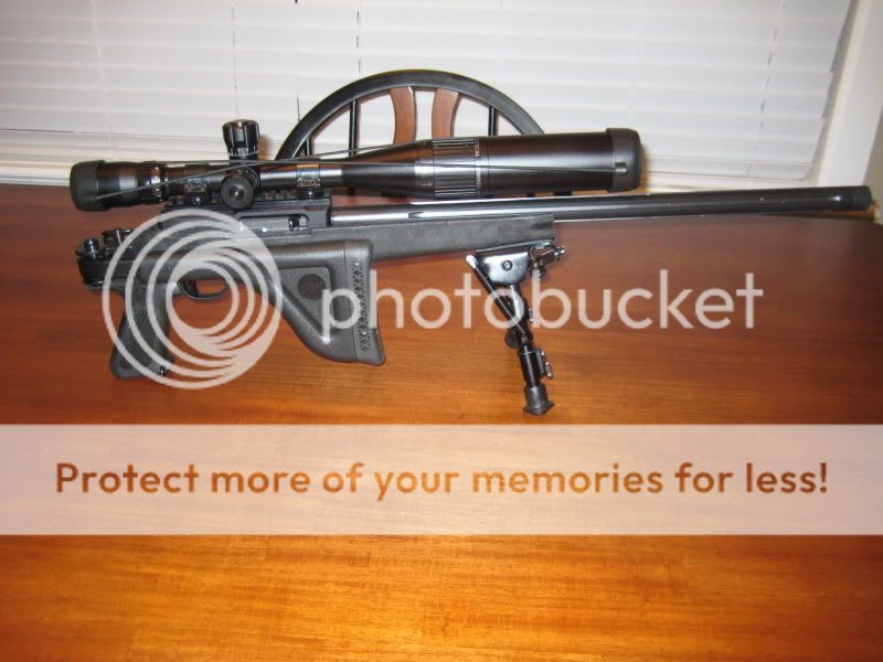

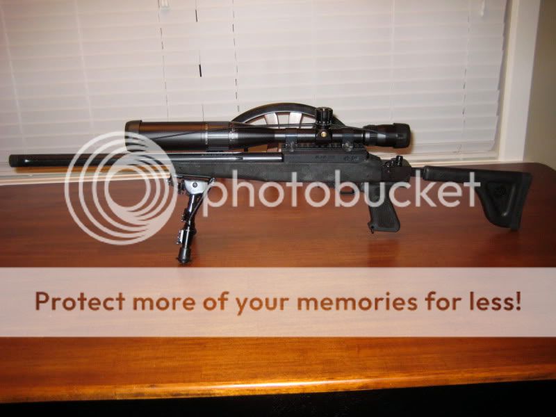

Here's a pic of the finished project.I went with a set of low mount Weaver tip off for rings, it mounts the scope extremely low over the barrel and I find I will probably not need a cheek rest to get a good repeatable cheek weld. The scope is a Bushnell Elite 3200 5-15x. Range report this weekend!

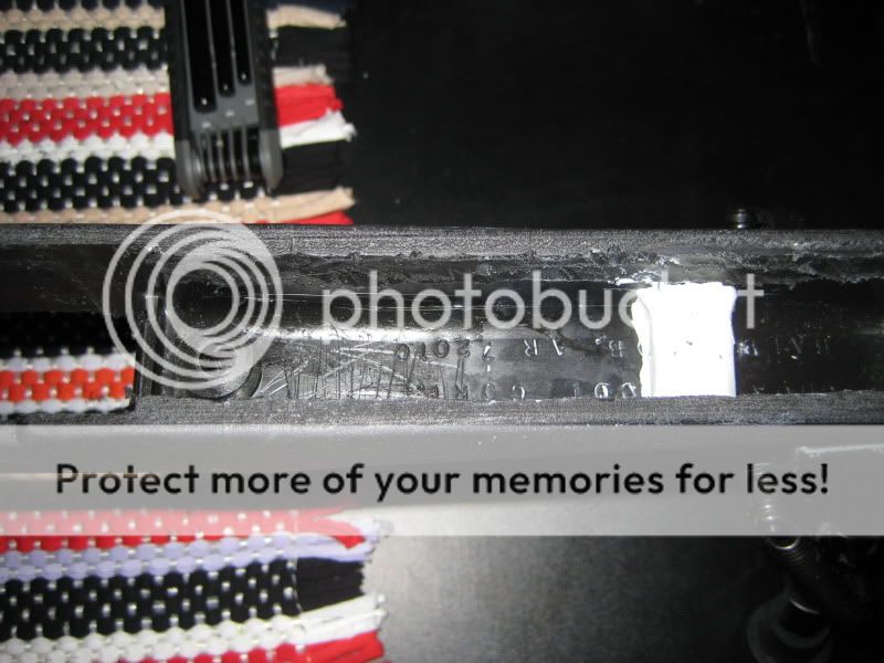

Here's a pic of the stock as I was placing the putty in it to work as a dam against the JB weld. I actually moved it forward about a 1/2 inch from this photo but you get the idea. I've since cleaned up the inside of the walls of the stock and you can notice where I started to rough up the bottom of the stock well to help the weld stick better. You can also get a sense of the silly design of this stock with just a small pillar of plastic for the action screw.

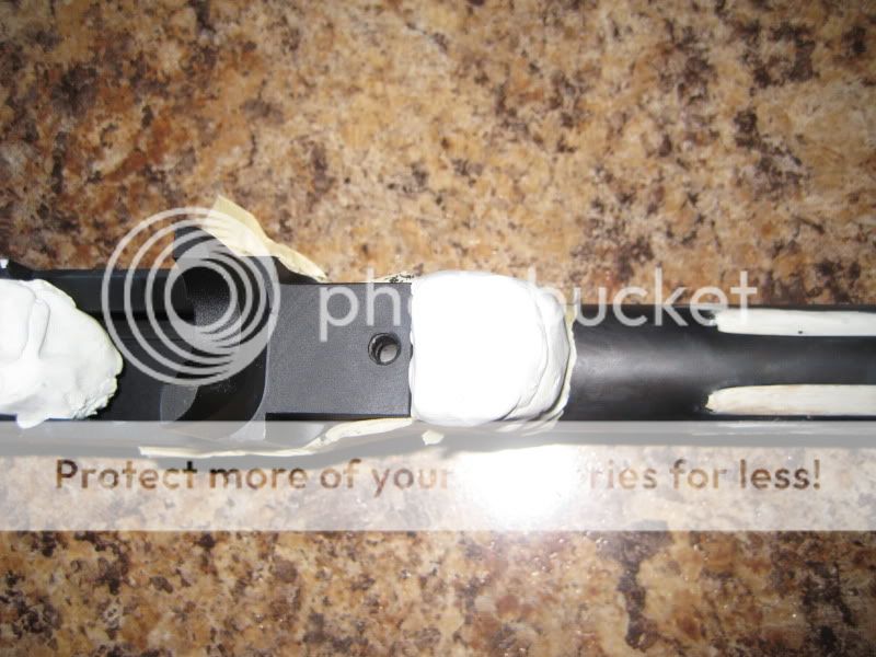

Here's another pic of the action just prior to bedding. To fill the action screw hole, I just filled it with putty. For the action screw hole in the stock, I took a straw, packed it with putty, wrapped it in masking tape to get it to match the size of the hole, slathered it with shoe polish and jammed it in there.
