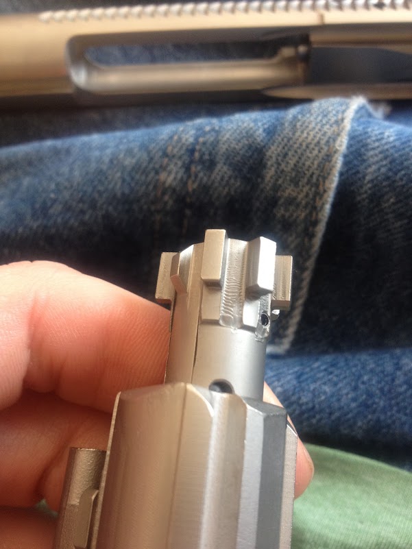

Got mine today.
To KENDO: The machining looks good? If you can see it...then it's not good.
My Review:
Lots of chatter on my bolt, Dull tools?
No chamfer on the Bolt lugs. Gas key looks obviously cast.
Machining marks everywhere on the carrier.
Ejector Roll pin to long...just kind of hacked off. Not counter sunk.
LAST BUT NOT LEAST!!! THE GAS TUBE WILL NOT GO INTO THE CARRIER
So , again. Back goes another defective product to DLASK.
edit: Yes the staking is half ass.
I have the same issues. Will not fit into any of my receivers either due to the gas tube. Will also be returning it.

My turn for show and tell. I was going to wait until I had talked to Ice Arms, but what the hell.
One of mine is OK (not perfect mind you. still a little rough). The other looked like the following:
To be honest I was a bit disappointed to see this, especially after the long wait.
They seem to lock into the barrel extension fine, but I don't have a gas tube on it yet so we'll see. Staking is weak as well, but I haven't touched it up yet.
I hate to say this but the spare DPMS BCG I have kicking around has smoother machining. I'm sure Ice Arms will get better at this, but it sucks to be the guinea pigs.

See this is what I'm talking about. The valleys between the lugs are ugly, yeah, but at look how smooth and immaculate the actual lug surfaces that matter.
I'm in the process of giving my BCG a good going over. I can't find any functional flaws with it as yet.
All the spots that matter seem to be fine.
After 100 rounds, not much I know, but I tried to tighten up the Gas Key bolts and they did not budge, which tells me that they haven't loosened at all.
As mentioned I plan to not touch the staking and monitor them for any movement.
