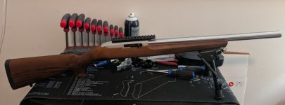

Mine arrived today fit seems excellent might have to sand a tiny bit for the safety it was a tight squeeze. Very happy with the finish especially for the price. Only thing I noticed was the stud holes were about 2mm to one side and probably 1/2 mm more gap on one side of the barrel. Oh and shipping was fast went out next business day

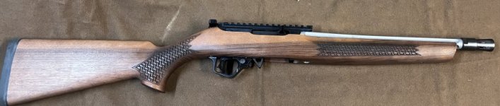

I put my rifle together using a Spectre ST-22 receiver and ran into a slight problem where the bolt was binding when the rifle was in the stock.
I took some 100 grit and gently sanded the receiver pocket until the gun went together easily and the bolt cycled without binding.
Since I now had bare wood inside I took some of the trade secret stock oil that a dear gunsmith friend had given me, and rubbed a bit into it.
Then I tried a bit in the barrel channel, liked the result and ended up oiling the entire stock. The finish it comes with is ok, but seems a bit "thin"
And the wood is stained too, btw - I sanded through that finish inside.
Anyway, this is my rifle Prior to oiling the stock (it's currently drying)
