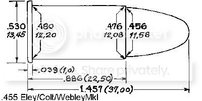

Nobody is making the longer MkI Webley/.455 Colt cases at present, but Buffalo Arms does sell them made from .45 Colt cases (which involves thinning the rim
from the front, as well as shortening them, so it definitely isn't an easy home project for most folks) -

Here's a picture of bullets from that mould, together with some cartridges as follows (left to right) -
- Factory load .455 Mark II.
- Factory load .455 Mk I (in this case, actually a Dominon .455 Colt cartridge - but that is really just a North American commercial designation for the Mk I cartridge.)
- reload in a Dominion .455 MkI/Colt case, bullet from the RCBS mould.
- reload in a .455 MkI/Colt case formed from .45 Colt brass, same bullet.
