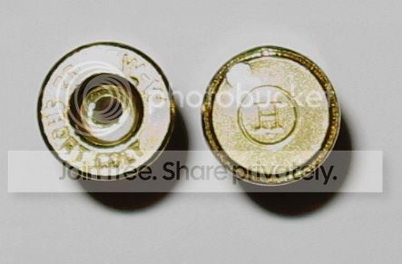

Here's my revised process:
Making 32 Rimfire
You’ll need:
  • 27 Cal Ramset Powder Charge - "Green" has about 2.3 grs of powder, "Brown" has about 1.7 grs
  • Winchester 32 Short Colt Brass. It's a bit shorter than 32 Long Colt, but easy to find (you have to make 32 Long Colt from 32 S&W)
  • a 0.311-0.314" Round Ball (“0” Buck sized down works well) – will weigh about 48 grs
  • a 17/64" and a 21/64” drill. A lathe is the best way to drill the holes.
To apply this to a larger round like the 38 RF, you have to offset the holes so the the rim of the Ramset is against the edge of the brass. I'd make a jig to hold the brass off centre and use a 17/64" end mill to make the cut. (my next project).
The beauty of this setup is that the Ramset is both the primer and the powder charge, and you don't have to line up the round to align with the firing pin. The powder seems to be like Bullseye in Burn Rate (fast) and for my Remington #4 Rolling Block, "Green" contains a suitably mild charge for a 48 gr Round Ball. Brown 27 Cal charges are very difficult to find, and are required IMO if you go heavier than the 48 gr Round Ball. Firearms not as strong as the #4 would require caution using the Ramset charge - you might want to empty the powder and replace it will blackpowder, or a suitable smokeless charge.
I press the Ramset into place by squeezing it in using a vise - once in place, I do the same with the Round Ball, then put a dab of Alox on it. Notice below how the firing pin nicely strikes the edge of the Ramset (at 10 o'clock). There's no need to "index" the round like the "HC" method requires.

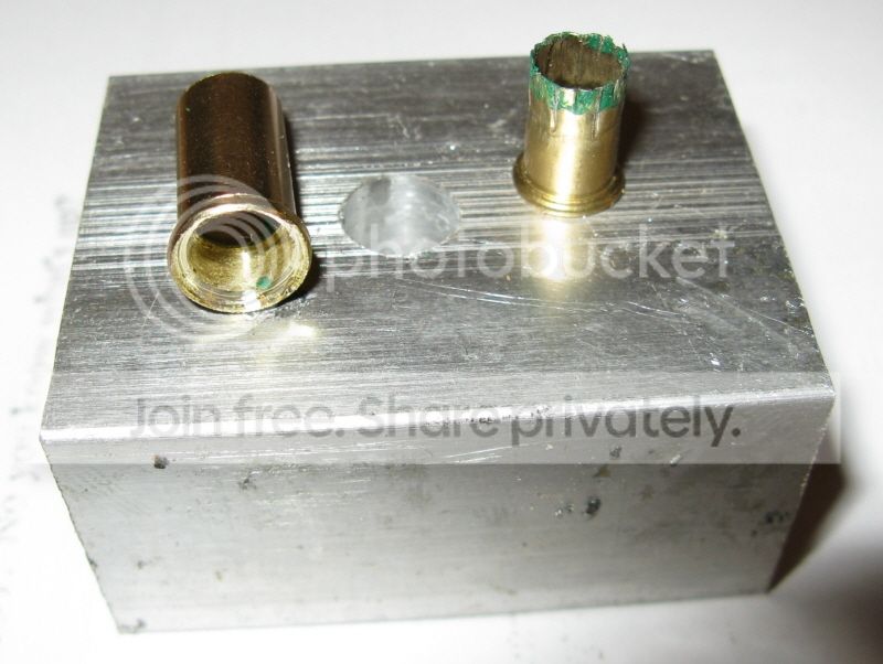

To deprime, drill a two step hole into the base of the 32 Short Colt Brass - a 17/64" all the way through the web, then a shallow 0.328" (21/64" drill), deep enough that the Ramset charge sits flush.
See below a shot of the two-step hole, and a fired Ramset Charge. The Aluminum Block has a 21/64" drill sized hole - I have since drilled a shallow hole the diameter of the rim, (to centre the cartridge over the hole). I use it to deprime using a metal rod and a small hammer.
