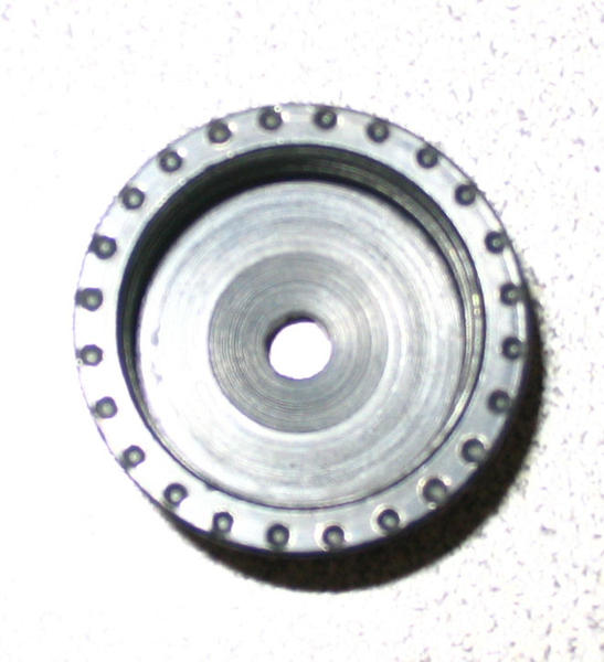

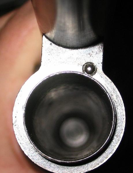

so I have been using the 18.5" barrel, and it seems that the ring that goes around the tube is too thick, I can't tighten the end cap tight enough and it comes loose during use. Is this a common problem with these barrels? I can't really use a barrel that comes loose during use...other than that its a good value, but this is sort of a junky development.
I would like to hear back from the staff if possible? I am thinking about grinding some of the thickness down to allow the end cap to screw on more. I have an 870 wingmaster.
The wingmaster barrels use a ball detent to retain the cap vs the notched plastic insert used on the grizzly/express. You can use loctite, some have converted to the ball, or possibly the plastic insert will work in the wingmaster (no dimples)

You need a wave washer same that used onany semi autos. This will alow u to use both system of bbl on the DA guns no issue
After some research, I found advise to use a rubber o ring instead, I'll be trying that out. Also, I have found that the "ring" that goes around the tube is thicker than my other barrel, the end cap doesn't screw on as much, so I need to grind that down to get the cap to screw on more.
