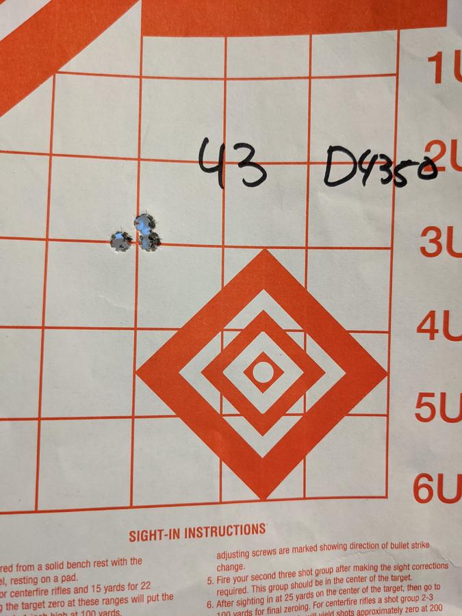

I'm happy with it.
43gr D4350ssc.
6.5 creed. 140gr SST.
2620avg fps.

I'm curious as to what your barrel length is for that velocity and how full your case was. Was it a compressed load at 43 gr?
I have a decent load with Win Staball 6.5 that's 2600 fps and I have some really good load data for it. It's just become a huge pain to find in anything more than 1 lb jugs. I'm looking to replace it with D4350 but have heard some mixed things on the velocity I might be able to get from it.
24" Rem 783.
I actually don't recall if it was a compressed load. I would say if it was not by much. I don't generally crunch powder.
Like it has been said here before. It is slower than IMR. By about 2grs in the Creed.
When the powder was first tried out. I wasn't overly impressed. But after some work it seems to be alright. Might get 1 more.
