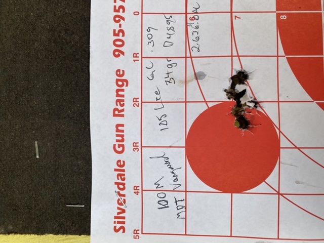

D4895 (and IMR/H 4895) are all and ideal burn rate for 308. I wouldn’t go with any faster a burn rate unless it was for cast. Even then D4895 can be loaded down no problem.
