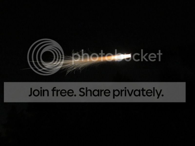

i ordered 5000 Domonion small pistol primer primers from Canada Ammo and did some testing to compare them to CCI, Federal and S&B (thought i had winchester as well but i don't or can't find them) in how "hot" they are and my impression of how hard the primers are.
setup/testing is as follows;
smith and wesson 586 6"
4 (same 4 cases) 38spl cases that have had the primer holes enlarged. i used the same 4 for each brand of primer
lighting was the same for every picture.
Dominion
Federal
S&B
CCI
they seem to be about the same as federal when it comes to flame size based on the pictures. my 586 will only set off federal primers reliable, most others (cci, winchester, S&B) i will have the a light strike every 12 rounds give or take. i only tested dominion primers and 1 had to be hit twice to go off, the other 5 went of the first time. i should mention this is in double action, in single all primers go off the first time.

I used a Nikon d600 on a long exposure on a tripod against a door. I had a it on a timer and fired when I heard the shutter open.

Two major variables in primers. The flash produced and the difficulty in setting the primer off. A revolver with a light hammer is required to detect sensitivity since most brands of primers will fire in any gun with a non-reduced striker spring. As your pictures show, there can be a big difference in flash. This is why Wnichester are better with hard-to-ignite ball powders.
I buy primers by the 5,000 case, and often buy multiple cases so my loads are with the same primer (and same lot#) for as long as possible. I have used multiple cases of Russian primers and liked them for everything except my mild 223 loads with ball powder. These pictures show why CCI magnum are better for the ball powder.
Russian small rifle
CCI Magnum small rifle
If you want to take your own pictures, it is easy to do. A revolver or pistol is best. You can test both rifle and pistol primers in a handgun.
In the dark, with flash set to OFF push camera button half way until it gets the focus, the click the picture. The shutter will try to stay open for a very long time (no light). When you hear the camera shutter open, pull the trigger then let camera button go.
You need a camera with a focus light so it will focus in the dark. If you don't have this feature, have an assistant use a flashlight to allow you to get the focus locked in.
