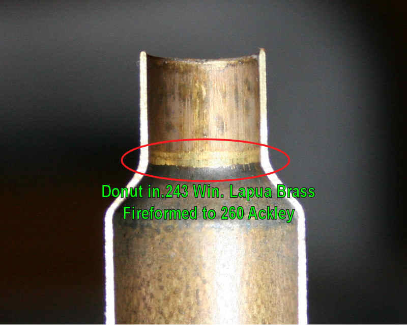

For the newbies, this is what is meant by "donuts":
