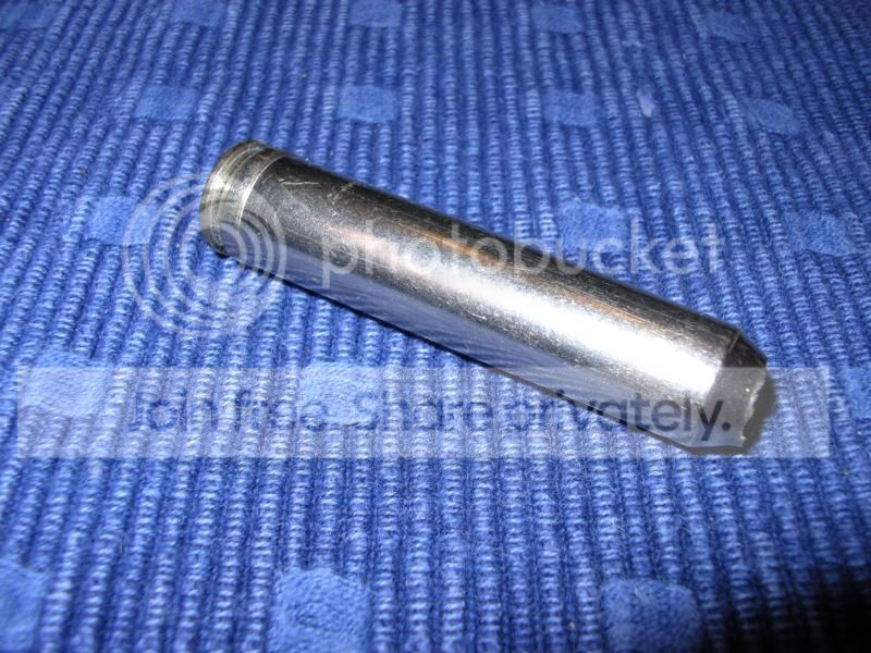

I have them. Dammit. I was looking over my 6BR brass before I try my hand at annealing, and a bullet would not drop through unsized brass. Used my Redding neck gauge, yup, donuts. I use a Forster bushing die, and can see that the entire neck isn't resized by the bushing, even with the bushing set at minimal float. I assume this and my .272 neck are what caused them?
I understand that inside reaming can be used to remove them. I have a Forster handheld outside neck tuner, this page seems to show that the reamers for their standalone unit will fit the handheld turner. http://www.opticstalk.com/case-neck-donut_topic12628.html
Another possibility is using an expander to push the donut to the outside and then neck turn, slightly cutting into the shoulder. Will the Forster expander ball fit my bushing/shoulder bump die?
I have sent an email to Forster, but I don't know how quick they are and figured I'd ask here too.
Lastly, I will be sending my 6.5x47 build off to the gunsmith shortly, and this issue has given me pause. I am planning to go with a tight, no turn neck of 0.293". I already have a Redding bushing die, but this one has a expander. Will this and outside neck turning be enough to prevent donuts in that brass? My 6BR bushing die doesn't have an expander currently, could that have contributed to the donut formation? I checked my .308, and no donuts even with that neck die having no expander either. But it doesn't have a tight neck.
Thoughts?
