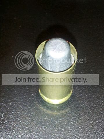

These were reloads sold by Moregun Supplies back in 2010. I am not sure if they are even still in business and they are no longer active on gunnutz. At the time, they were reputable to buy from.
One more picture showing improper resizing/crimping. I pushed lightly on the bullet and it fell inside the case. :(
