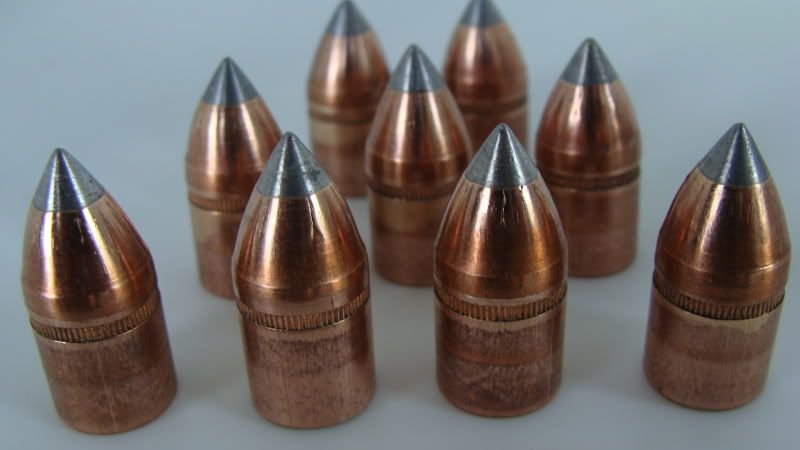

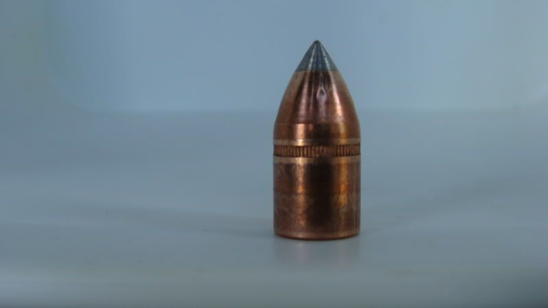

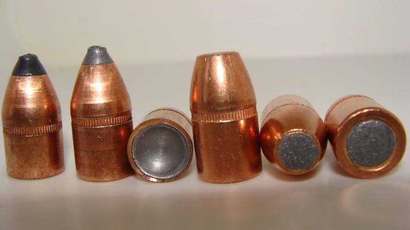

here are some pics.
just reworked my nosler die ( again ). Didn't quite like the blunt nose.
first attempt.
new improved.
don't know if it helps anything but they sure look pretty and a definate confindence builder. I'm sure it won't hurt performance or accuracy.
