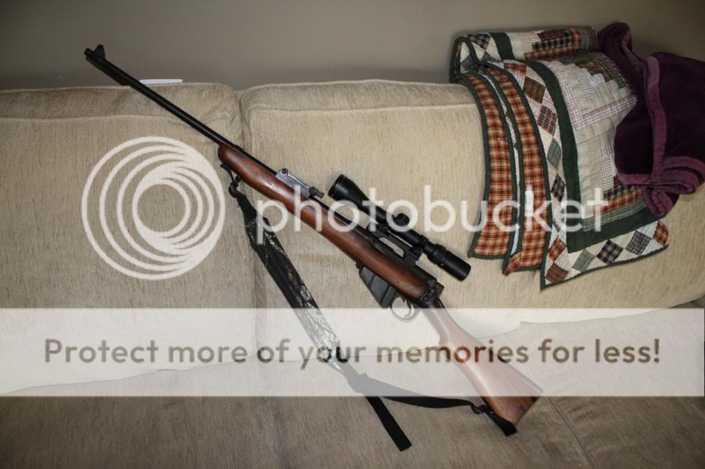

Got me S+K mounted up
You were a lot luckier than I was. My S&K "no gunsmithing" mount was installed today.

that would be this. This poor girl too was already de-bridged and D&T for the side mount so I went with it. It will hold the scope aprox 3/4" off bore axis.
Hummmm,,,, I installed one last week and it is dead on over the bore. I would have put the same thing on my own hunting rifle except that the Bushnell Red-Dot that I like needs large rings. Your rifle looks great BTW! Love the ATI stock.
