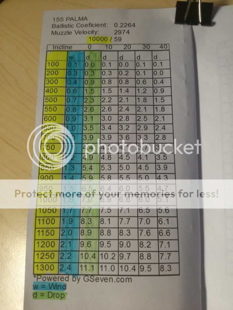

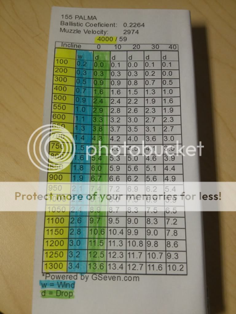

I have a hell of a time getting a drop chart that is within a 1/4moa after inputting all the data as accurratly as possible??? maybe I'm missing something
If your input data are correct, you should be able to get to about a quarter MOA or so. You need accurate data for your m.v., your bullet's BC (preferably a G7 figure, even better Litz's data), the air temperature and your elevation above sea level. Smaller factors that you might get away with ignoring are the humidity and the barometric pressure (depends on how accurate you need your results and what distance you are shooting).
