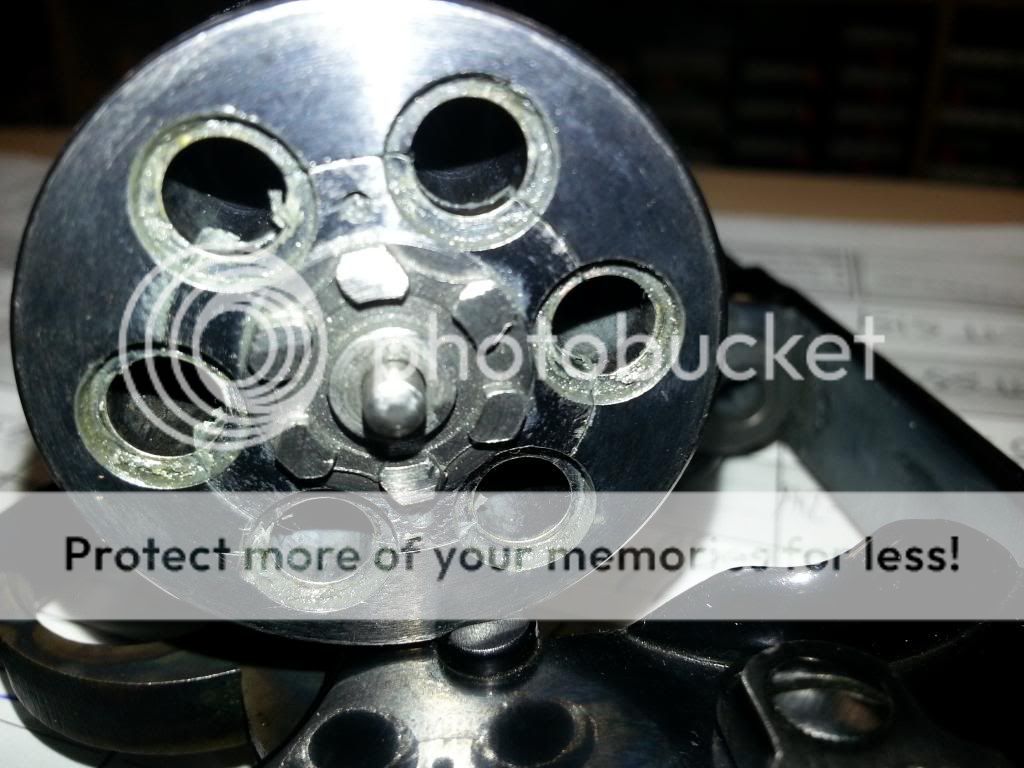

bottom left cylinder on my s&w 17 definitely looks like it was struck by the pin.
Has to be damage from something else. The FP doesn't reach that far down. If that is your gun take note before you eject the empties that the FP strikes on spent brass at the outermost edge and not part way around where that ding is located.
