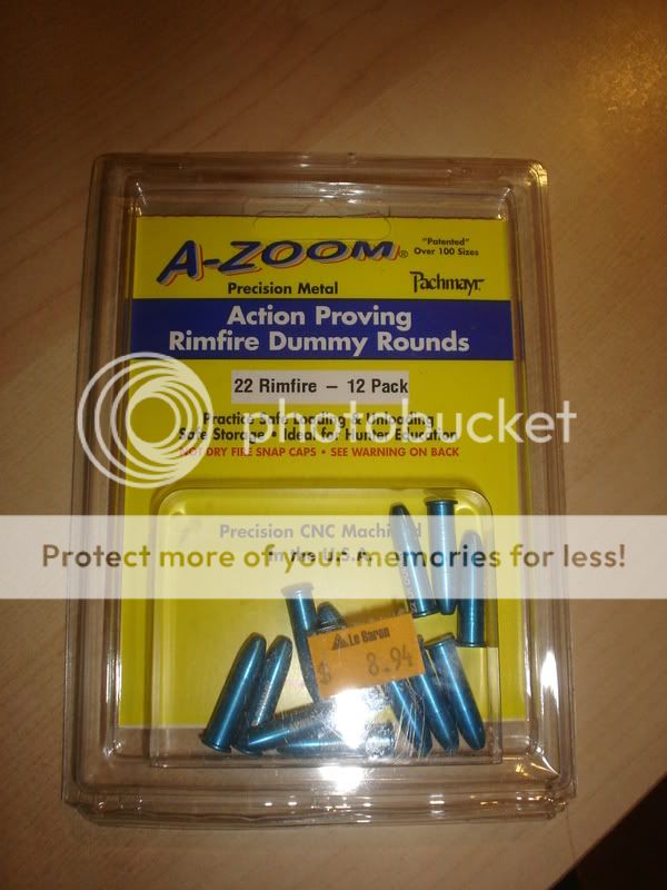

i wish a company would make snap caps for rimfires. and not snapcaps that only last a few hits, but ones you can use without worrying for a long time. i would definitely buy some.
