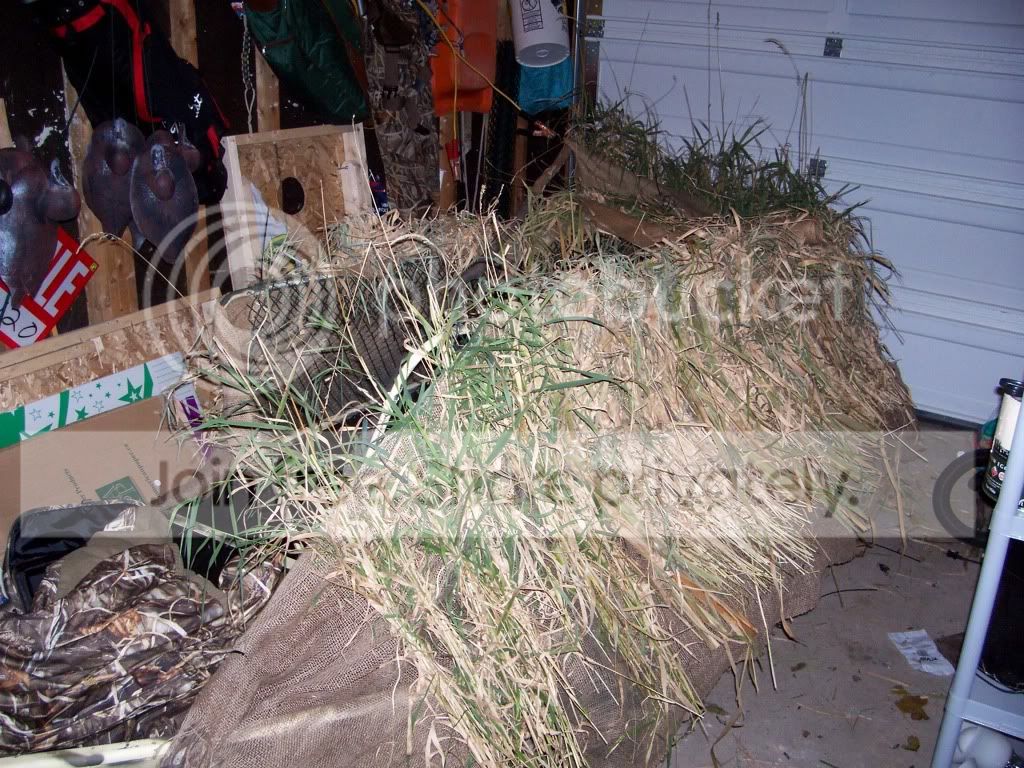

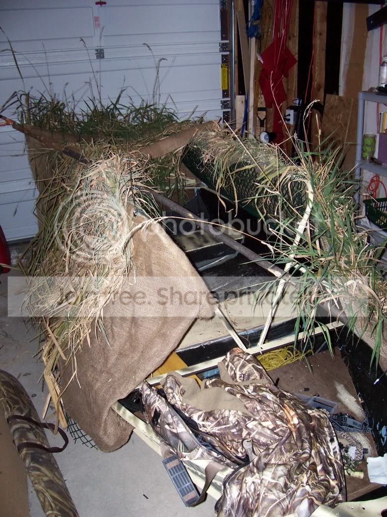

Built mine in my spare time over the summer. Cost less than $100 for the frame. Mostly made out of steel conduit. No welding or bending required. Attach to the boat using pieces of L shape steel or if you're really fancy, bimini hardware. Folds up, folds down. Now if only I didn't have to row to get to my spot...
It was still a work in progress when I took those pics. I'm switching out the green backing for green or camo tarp. The plastic fencing was too difficult to work with once out on the water. I like the refuge model but it doesn't work for my style of boat as you need flat front on it and casting deck in the back so I had to improvise.
The grass is on there via a plastic wool needle and is 'sewn' on using some sort of twine I got at the home depot. It held up really well for the whole season, all things considered. I forgot the camo part outside for the winter though so I'll see how firm the burlap is once I repaint the inside of the boat.
