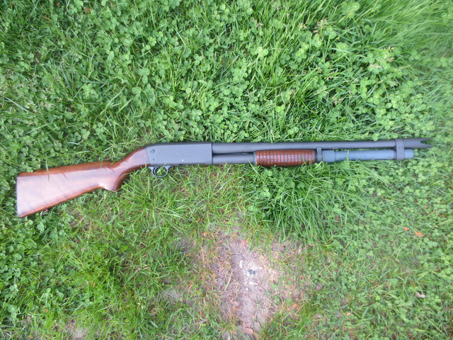

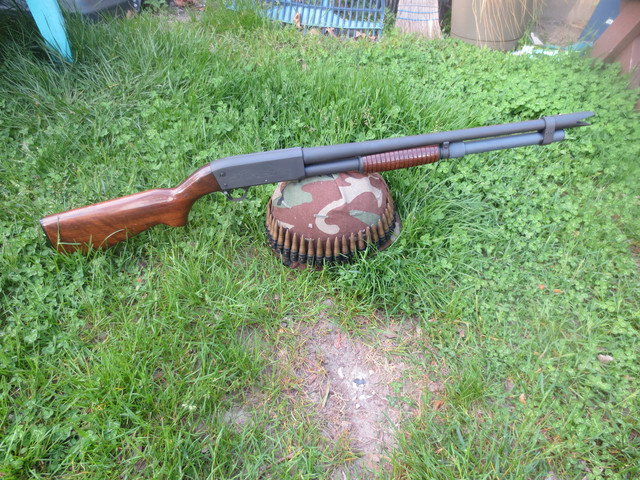

Duckbill ithaca 37
James "Patches" Watson would approve!
Have you shot it yet? I know I'd almost be scared to.
have not shot it yet but i will soon.
the knuckle was taken off the barrel and the clamp added in the place.
Very cool, I like it.
First time I've heard of a mag tube not taking parkerizing.
Would like to get a Duckbill spreader eventually, probably for an 870 though.
Interesting project, nice job JTF# .

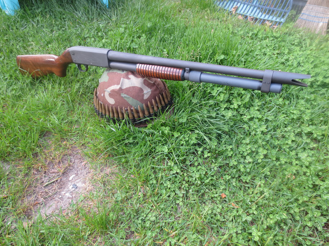

How was the duckbill added to the barrel? Silver solder? Threaded?
And do you have a closeup pic or two of the detail of the barrel clamp just past the forend? I guess the lug was removed from the barrel...was a new clamp soldered on or something?
-the mag tube would not take the parking because it was alloy of some kind. not real steel like the rest of the gun.
-Gary made the duckbill from bar stock. the gator is your best bet like madashell wrote.
-right now it is high heat epoxied on but after i test it if it all holds up i might get it silver soldered on.
-the lug is just soldered on. the mag clamp is like any other. you just need to have it on the barrel before you install the duckbill.
i will post pics of the target once i test it out. the real one was supposed to be 3:1.
Keep in mind that the original duckbill was designed to be used with #4 buckshot, 00 will probably be a disapointment.
dont worry i know. i just finished reading 'point man'. i am going to use birdshot also. i think if it is doing anything birdshot will show up the best on paper.
