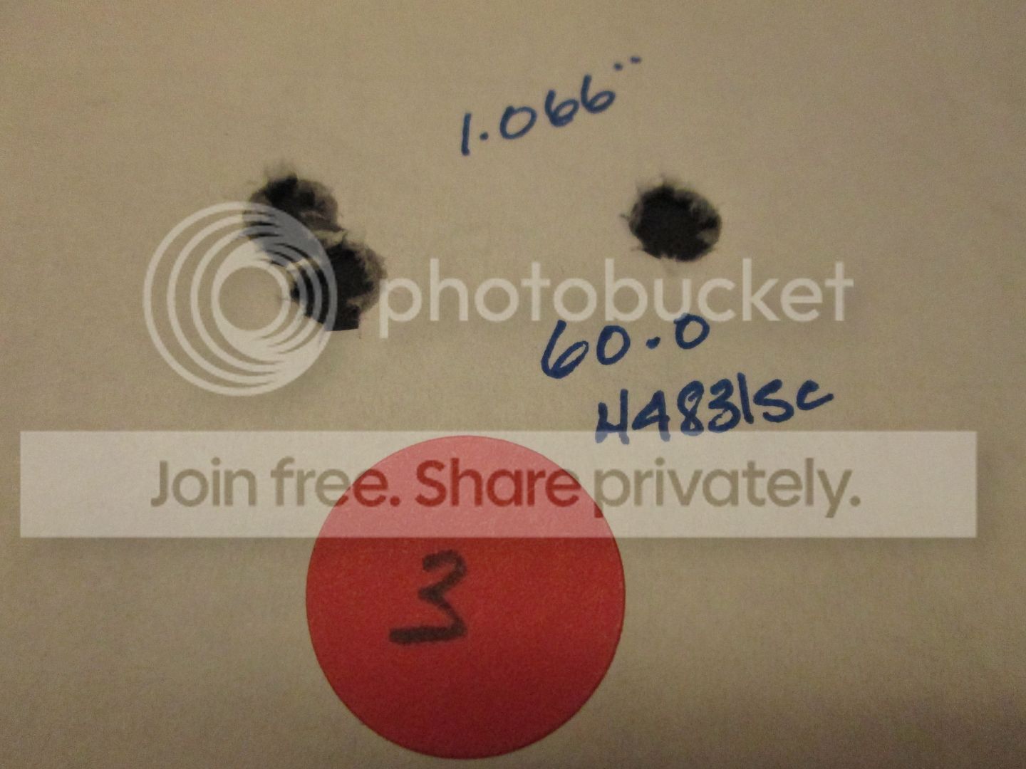

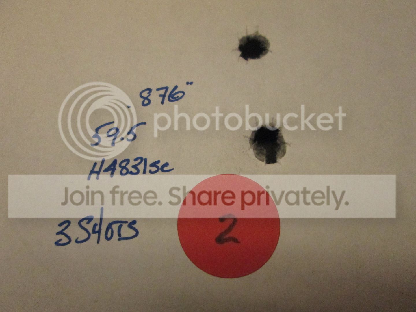

Looks like I have it fixed. Gave the bore a good cleaning last night and loaded up 15 rounds. No FTF in the bunch.
Last group of the day. :dancingbanana:
If the loads repeat, then it is powder charge related.
if not, then it is either shooter or set up or something rattling around on the rifle.
as you have shown, powder charge tuning can have a profound affect on your accuracy AND consistency. Test further and play around the best charge level in 0.1 or 0.2gr increments. if the shooter and set up is consistently accurate, you will see a difference on target.
Enjoy and glad you got that resolved.
