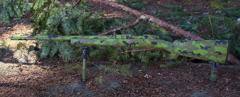

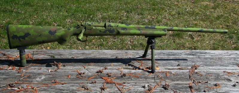

All done! now just to wait till the weekend for it to harden enough for me to put it all back together. I decided to only give a light OD coat on the bipod and monopod as it would have taken me too long to cadpat them plus I might want to switch them onto another rifle eventually.
The biggest pain in the ass so far now has been prepping everything for the clearcoat.
All of the stencils and masking take left a lot of tape film over everything and it was a pain in the ass to remove. After wiping it all off with my finger, clothes, and eventually a light alchohol based cleaner did the trick. Took my most of the today and last night to do.
The Clear matte coat does a great job of reducing the glossy finish, more than I expected really.
I bought some 1500 grit sandpaper but now it looks I won't need it after all. I did though get a couple blotches of clearcoat on some spots when I started to spray but I should be able to lightly sand them down evenly on the weekend.
So, pics to come soon!
I still have a little bit of black and light green left and a whole little bottle of hardener here too.

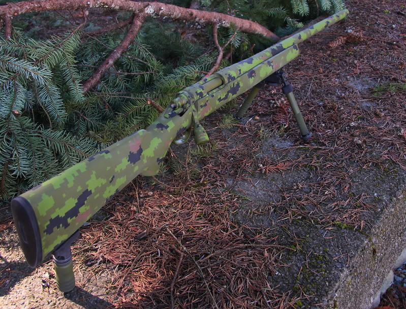

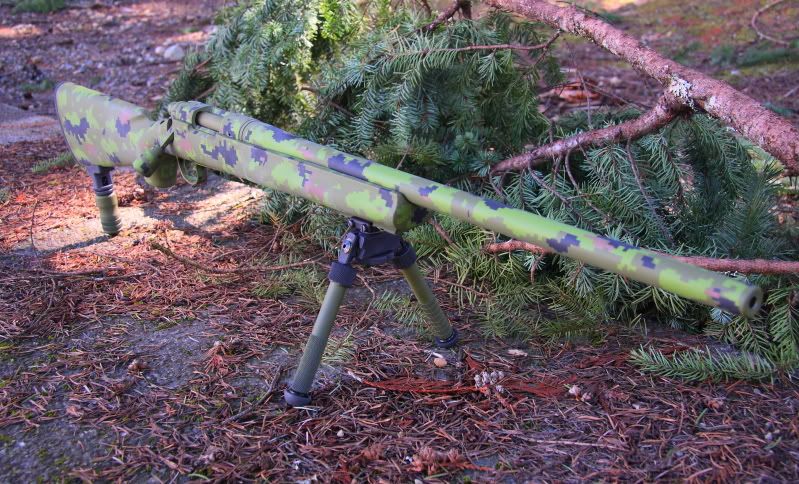

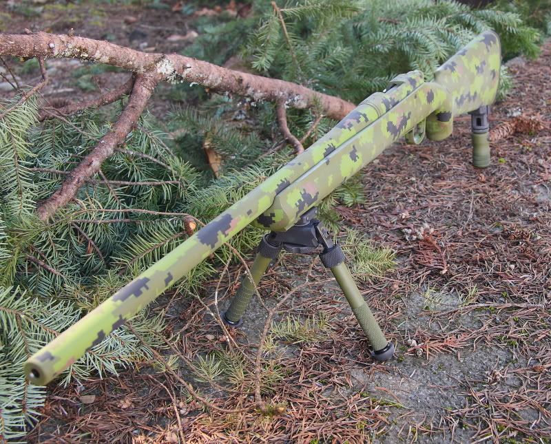

Ok done and put back together!
There are a little errors where I put on too much clearcoat but you can't tell in the pictures
Overall I'm really happy with it.
After taking the pics I took it back to where I store it and put the scope back on. I won't be painting the scope simply because I don't want to permanently tie it to the rifle, so I will be wrapping it with Cadpat fabric instead. Did a test of it and it looks really good.
