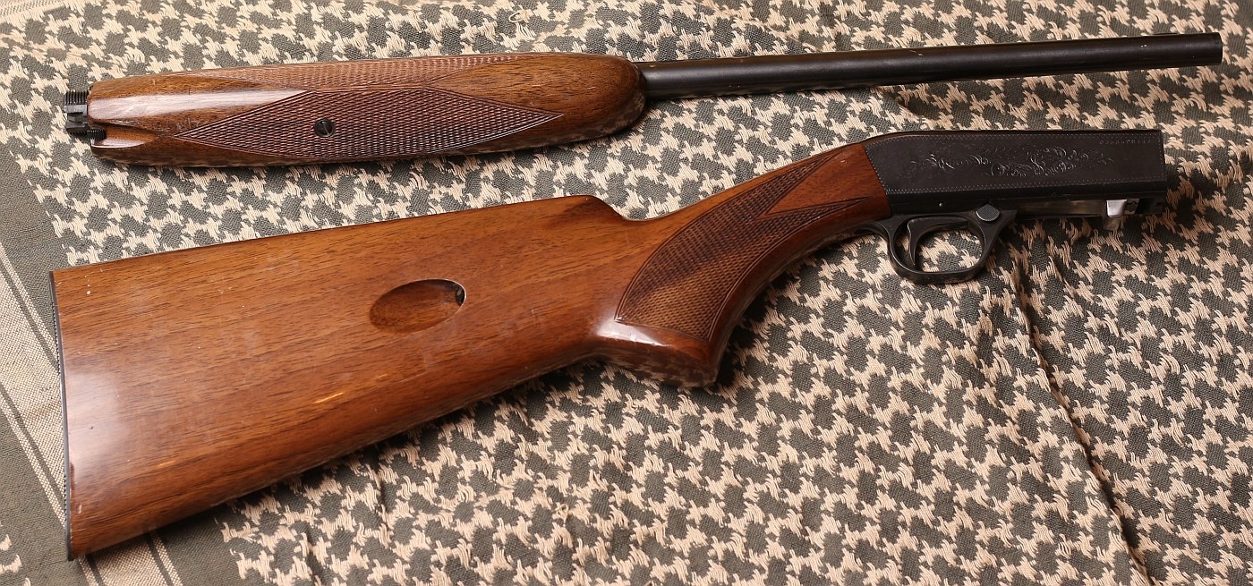

I might think the Browning SA 22 would be the gold standard rifle for one armed shooters, the gold part reflecting the cost of the things. But it's a semi auto with an easy to load tubular magazine, no removable mags to fumble with, excellent quality too. If I had a one armed friend, I would recommend they take a look at one if they turned out to really enjoy bench shooting. There's a Chinese clone of them around too, a Norinco, IIRC, Boston T Party speaks highly of them but I don't because the only one I've seen had the sights canted off to one side by 10 or 15 degrees, which doesn't speak highly of the factory's quality control.
The only problem with the SA-22 is that disassembly for cleaning will be extremely difficult if not impossible for a one-handed person.
I was concentrating on ease of shooting, the guy clearly has at least one friend that could handle such things as disassembly if he can't do them (but you might be surprised what a one armed person can pull off). The only Brownings I've seen for sale though had all kinds of gold inlay engraving, in that way that Browning has sometimes.
