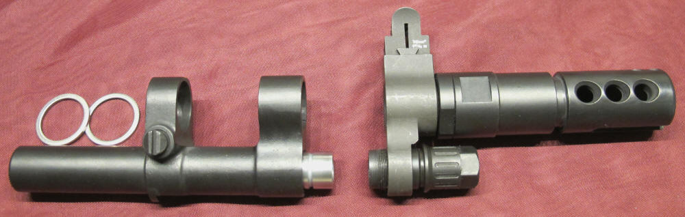

Installation of the Blackfeather is comparatively easy to perform. The hardest part (other than removing the Norc flashhider) is installing the new Op. Rod. Guide (ORG) and ensuring that this is perfectly aligned. Start to finish the install took me about an hour. I have heard about two other Blackfeather installations where the experience was similar to mine. Once the ORG is installed and the receiver parts are re-assembled, the rifle drops right into the stock. The tolerances are incredibly tight while still allowing easy assembly.

EBR installation was easy, plus it requires shimming, not sure about Blackfeather though. Most hardest part was to remove welded muzzlebreak on M305 and align op rod guide.

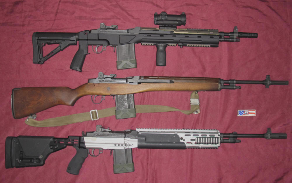

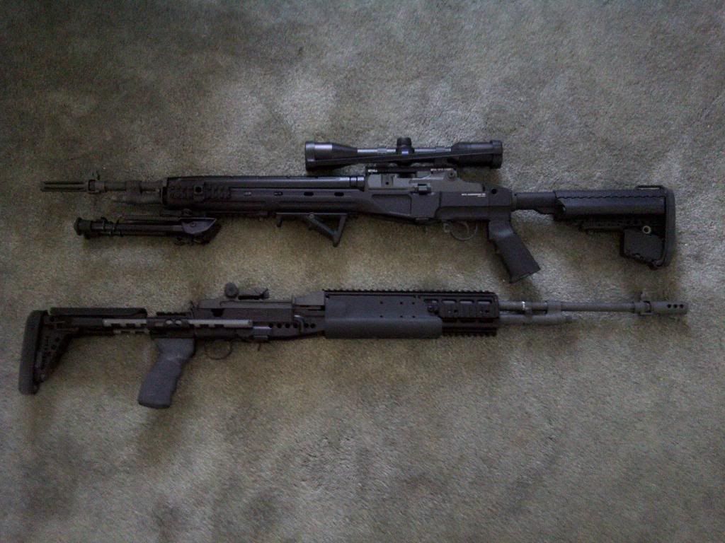

I own both and can't really tell you which is better. For fitment the Blackfeather does seem to have a better fit than the Sage with the M305 the receiver sits almost flush with the Blackfeather stock while the Sage does have a little gap. My Sage was pretty much a drop in (exluding changing the connector pin) and had none of the trigger group fitment issues that were listed above by some others.
As for styling well that is really personal preference. I prefer the looks of the Sage over the Blackfeather, however, I do like the styling of both of them.
Can't really comment on the accuracy improvements on the Blackfeather because the M305 that I put in the Blackfeather couldn't hit the broad side of a barn and I haven't invested the time yet to really find the problem with it. It is still having accuracy issues in the Blackfeather but I don't believe that to be of any fault of the stock. The M305 that was put in the Sage was a lot more accurate and does seem to be a little more consistent now that it is in the Sage.
