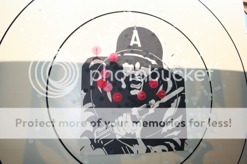

Not the best shooting(though certainly not the worst). I don't even think this was the best of the day, but this is 10 shots(of 10) from 500m prone unsupported with a 16inch tube(IIRC), and RUAG ammo:
It is also not mine.
