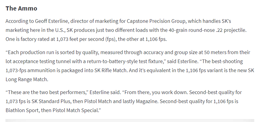

What is the SK hierarchy? For what it's worth, it was explained by a Capstone official in 2019, who was quoted in a Guns & Ammo article.
See https://www.gunsandammo.com/editorial/cz-usa-model-457-22-lr/365081
For nominal 1070 fps ammo, it's SK Rifle Match followed by SK Standard Plus, SK Pistol Match, and SK Magazine, regardless of pricing.
For the faster 1106 fps ammo, it's SK Long Range Match followed by Biathlon Sport and Pistol Match Special, again regardless of pricing.
Note that it's quite possible to have a lot of a "lower" level ammo outperform a higher one. This is true of all match ammos.
Note also that while SK is produced at the same facility as Lapua .22LR ammo, it's made on different loading machines on different production lines.

grauhanen, Thanks for re-posting that letter re SK products. On the Lapua site there is info on each of their rimfire flavours - https://www.lapua.com/products/rimfire-ammunition/
