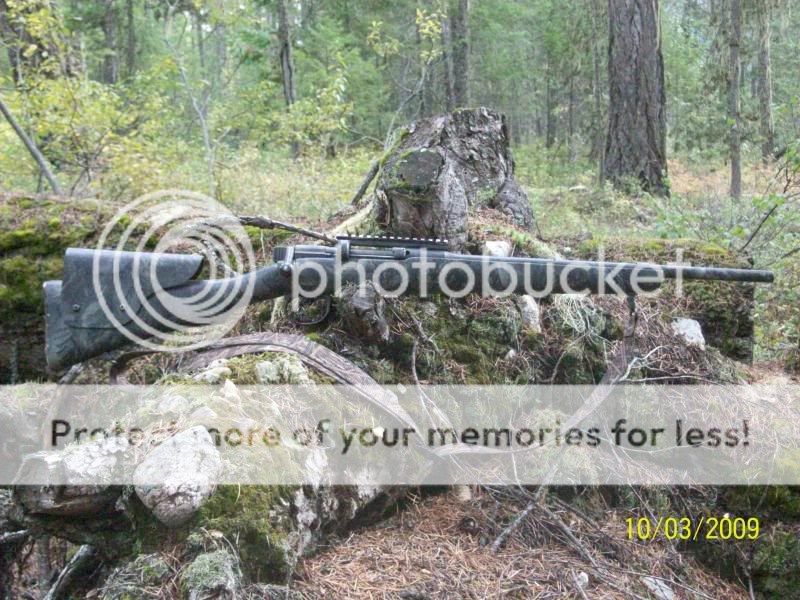

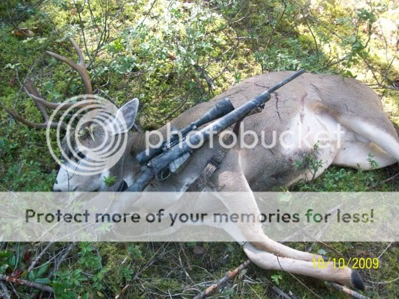

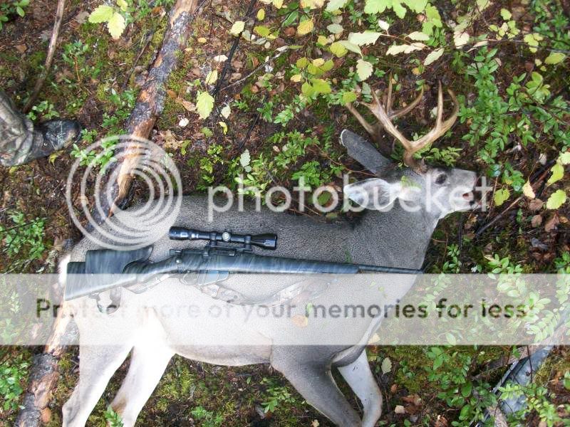

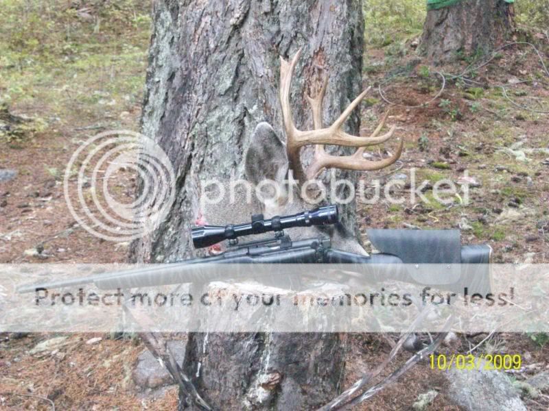

this is what i did to ..... and do with..... my old girls. ;)
i love the no 1 mk3 , my second favorite rifle. my first rifle, a full wood lithgow with matching numbers, still remains unmolested. however these two beauties where far gone for original restoration but the chambers and bores were good, so..... these are just 2 of the dozen or more i've done up for fellow hunters
Rebarreling may prove way too costly, and un-needed as well.
If you were to bone up on #4 bedding technic's, set it up properly, then do an 'Agressive Bore Cleaning' with alternating strong copper cutting solvent and brake cleaner .... once down to bare bore metal she'll likely shoot much better.
Okay M14 doctor, I give up. What rail do you have on that :D
I have a sportarized No4 which I had an aluminum ATI rail on it (i wasn't impressed) so I've gone back to the irons. Would still like a rail on her but no idea where to get a nice solid steel one.
Ahaa ;)
Custom my friend.
I am waiting till I can put a good mill and machinist in my shop,my machinist is off upgrading his CNC abilities, then that mount will be availlable to all :D
The top rifle's mount uses the same holes that the weaver T-01 uses. A great many MK3, shtle 3 ect , came with that T-01 and it was a popular gunsmith's mod in the 70's early 80's
The lower rifle in the pics has the T-01 on it still.
