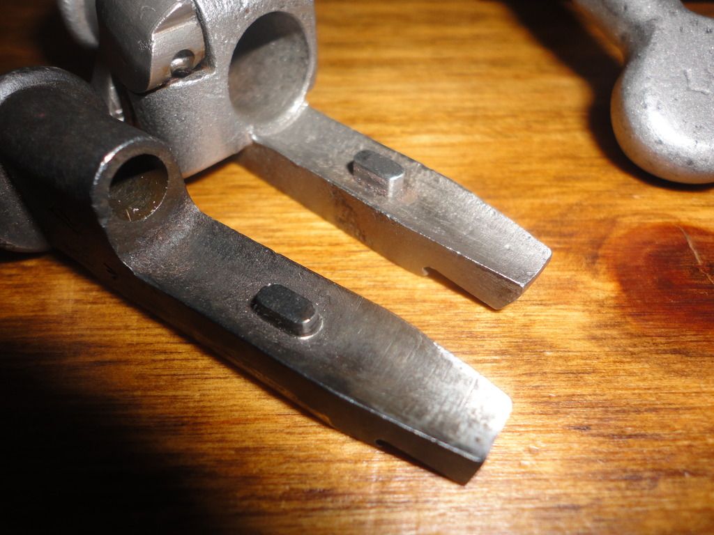

Looking at your photos, I doubt the cocking piece is the problem. No harm though in trying a different part, though. Do you have a firing pin removal tool?
Maybe I need to try another cocking piece
That cocking piece looks fine to me and is correct for your rifle.
The later cocking piece in the pics was a late war expedient type that proved itself to be acceptable and was carried over in later production. The portion at the bottom is identical to the cocking piece in your pic.
There are no blemishes on your cocking piece to indicate it's your problem

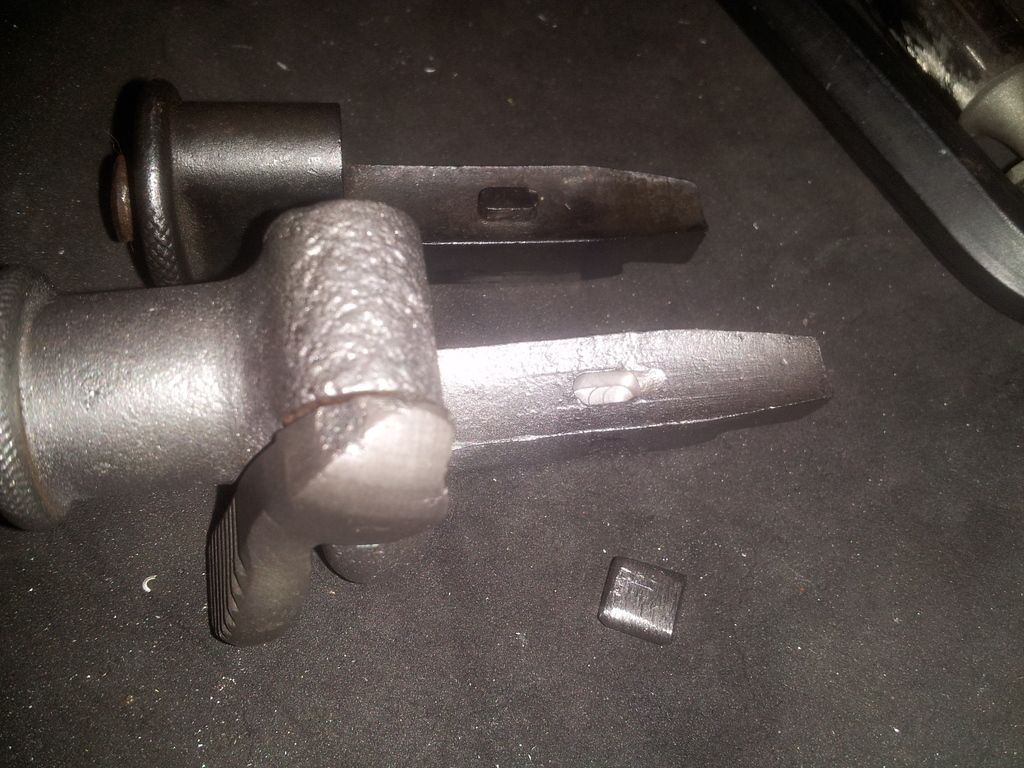

I didn't read the thread. But I have a Lee Enfield that the cocking pieces little key was worn and would just lock up in the ramp on the bolt body.
but also the ramp on the bolt body could cause the same issue.
I ended up replacing the key on the cocking piece and it works as seen in these pics

If it is the "key" on the cocking piece, likely the bolt cam areas it runs on are in bad shape as well.
