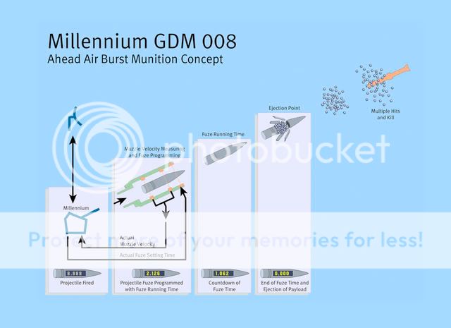

What's more, you can't tell a .50 to 'stop' if it goes too far:) So in your scenario if you're in a harbour full of civilians 1600m away and terrorists are charging from 900m, an explosive cannon shell is safer for the civilians than the .50 bullets, because the cannon shell will drop sooner, and it's fuzing options mean it can self-destruct if it misses - of with AHEAD just in front of the target.

It just seems that the only reason to choose those would be $, $ to buy, $ to maintain, and $ to shoot. But the basic trend, I think, in militaries that are buying good gear is that they can't get real cannons fast enough or big enough. Even in a city if you fire .50BMG at an apartment it will go through the walls, if you fire programmable 25mm it will burst inside the room.
