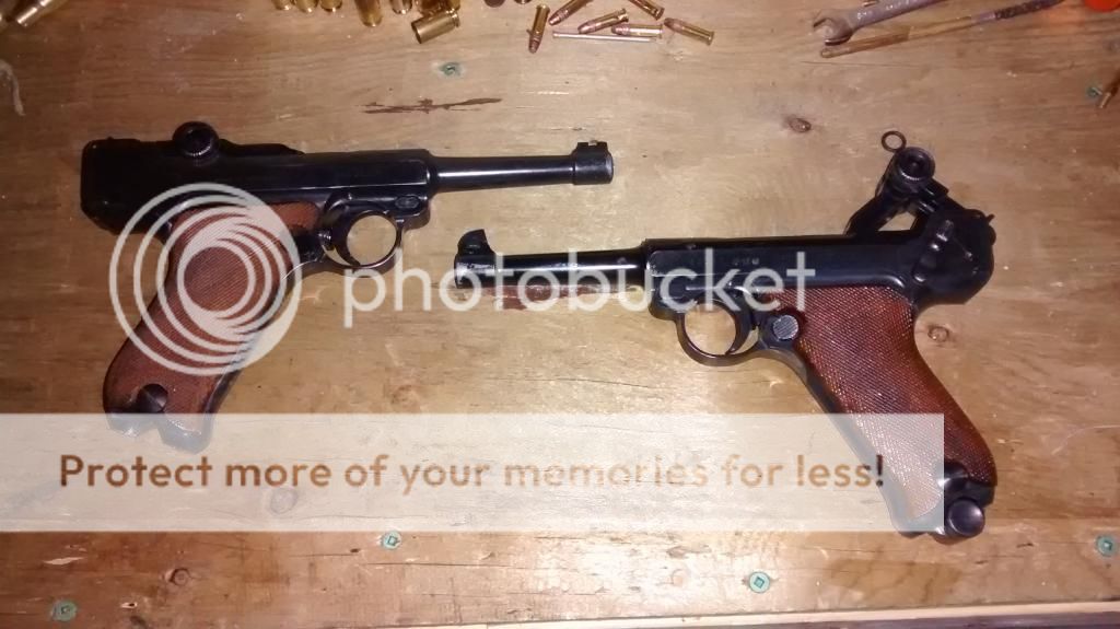

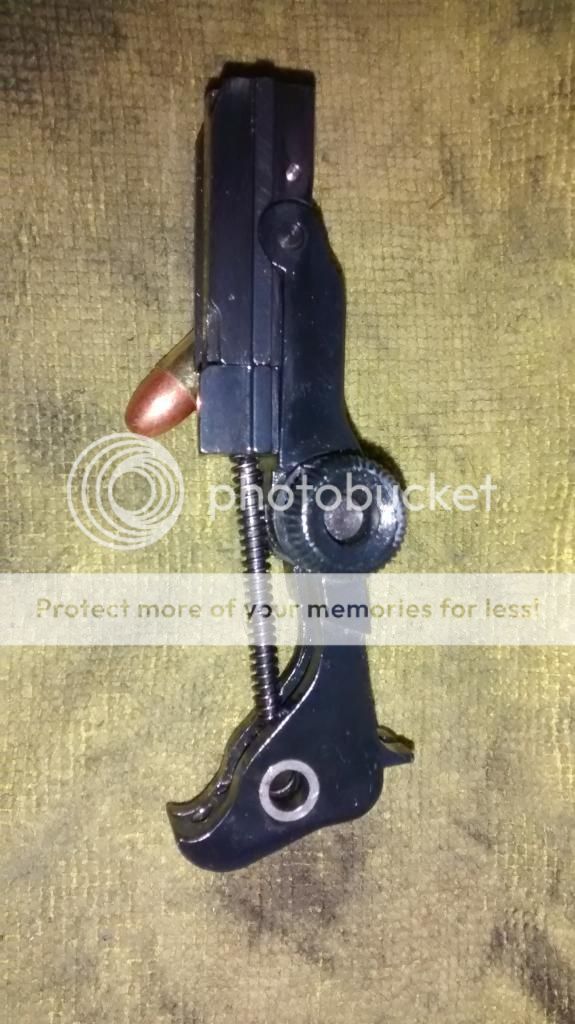

An Erma .22 was the handgun I had. Hotter or high speed ammo fed through it more reliably so perhaps trimming down the toggle spring would help? That would be my guess but ask a gunsmith.

Squeezing the lips a little should fix it.it looks like mine is a problem with the magazine, its jamming the nose of the round into the top of the chamber, I've tweaked the feedlips a little and I'm taking it to the range today to see if its any better.
Unique mechanism the Lugers. I know nothing about the 22's but the 9mm's want a slow round with lots of spring under the magazine follower. It's a kwerk required to properly digest the straight walled round.
If you have enough magazine pressure you can run ' Sub-gun' ammo through it, reduce the spring pressure and it'll run poorly.
But as I said "This is the 9 x 19 round "
Maybe some of this theory could be applied to the 22, I'd almost think not though. That'd be too easy.
Hmmm, Wiki seems to have an opposite view from what I've read.
Does the bbl recoil a short distance on the .22's as well?
