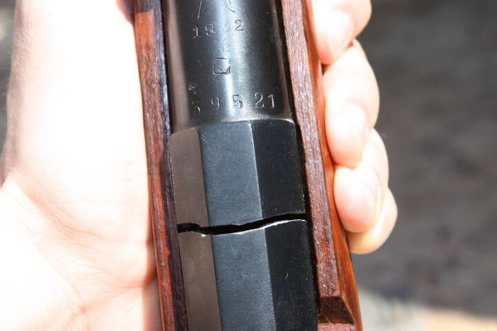

That could have been a bad day for you and mr.yugo...good thing you checked !!Never had any milsurps catastrophically fail on me but I almost did.
Out hunting Whitetails with my Yugo M59 sks back in 2007. Was using PMC 123gr soft points.
Saw a small buck and pulled the trigger, "pop". Was going to chamber another round but deer was already spooked and alarm bells were going off in my head. Said screw the deer and took the cleaning rod out and checked.... and well this is what I found halfway down the pipe:
. Shattered stock, action was split like a banana, lugs set back, brass "brazed " on to the end of bolt and barrel laying a ways away. Interestingly enough bullet was half way down barrel, later pushed out without any effort with a cleaning rod. Can post pics of action when I get home. I keep the action by my reloading bench just to "scare" some people
